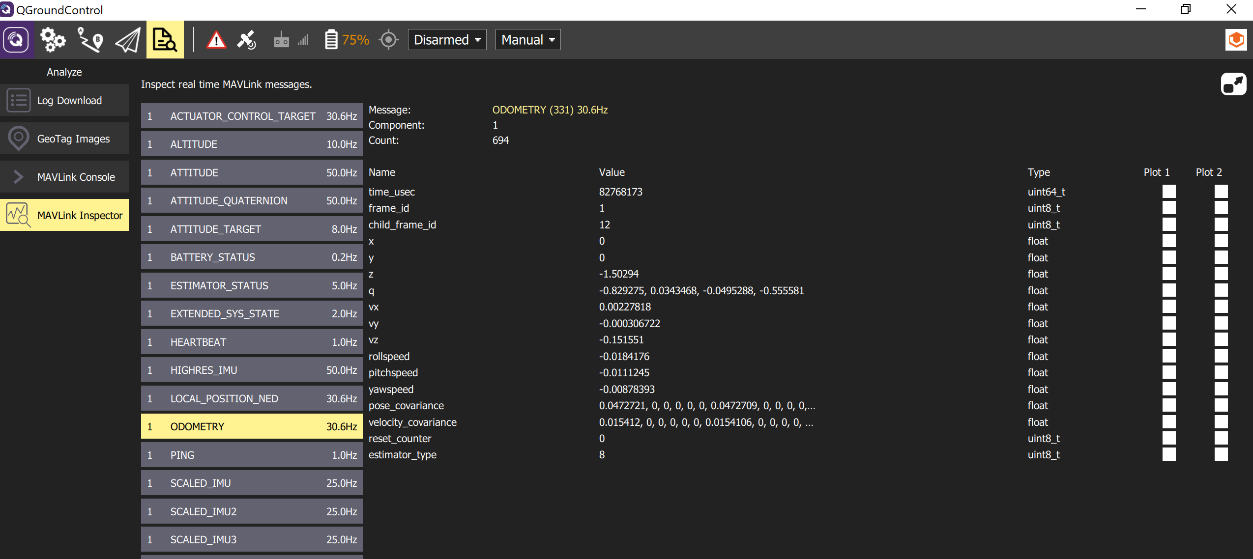

              @Chad-Sweet when connecting QGC, there was no odometry in the mavlink inspector. After that I ran voxl-configure-modalai-vl
              • Pavel ArdashovP
                Pavel Ardashov @Chad Sweet
                @Chad-Sweet now the odometry data is in the mavlink inspector, but x and y = 0
                • James StrawsonJ
                  James Strawson ModalAI Team
                  Hello, When you ran the wizard, what did you enter for the camera configuration question, it should have been option 3 (hires+stereo+tracking) for a flight deck.
                  Do you mind running voxl-vision-px4 manually in odometry debug mode to see if VIO is working and share the output? You can use this command:
                  voxl-vision-px4 --debug_odometry
