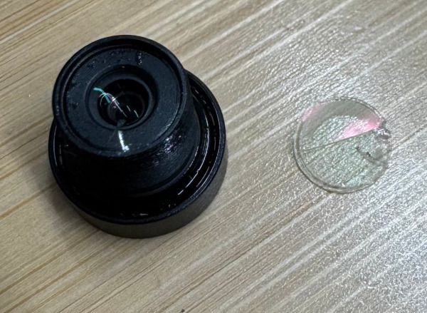

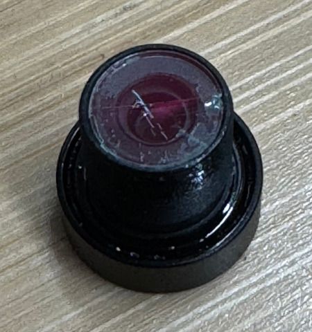

          I just tried to remove the IR filter and i was able to remove it, the filter was broken in process. I unscrewed the lens from the lens holder. The adhesive holding the lens in lens holder, if present, is not permanent and can be scraped off if needed. Then I used a sharp point of an x-acto knife to pry the IR lens off. See images below.
