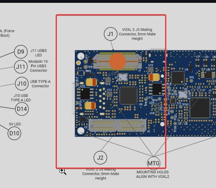

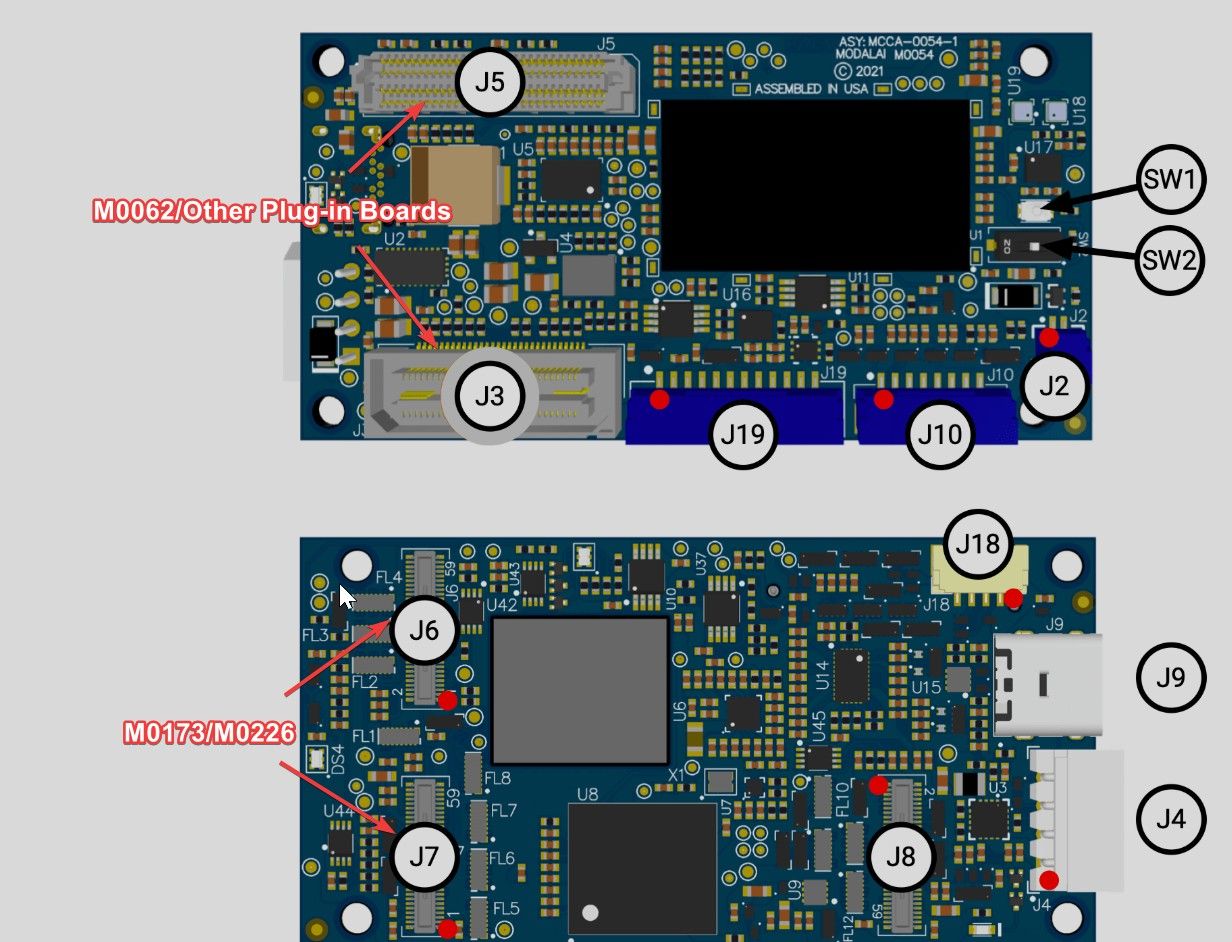

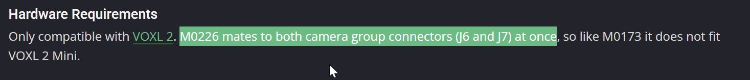

    Do the M0226 and M0062 fit together physically on one VOXL 2
    • VinnyV Offline
      VinnyV Offline
      Vinny
      wrote last edited by
      Sorry @senja for the delays, this post did not get flagged for me.
      Yes, they install on different sides of the VOXL 2 board as shown here:
      https://docs.modalai.com/voxl2-connectors/#connector-callouts
      https://docs.modalai.com/M0226/#overview
      https://docs.modalai.com/m0062-datasheet/#connector-callouts
