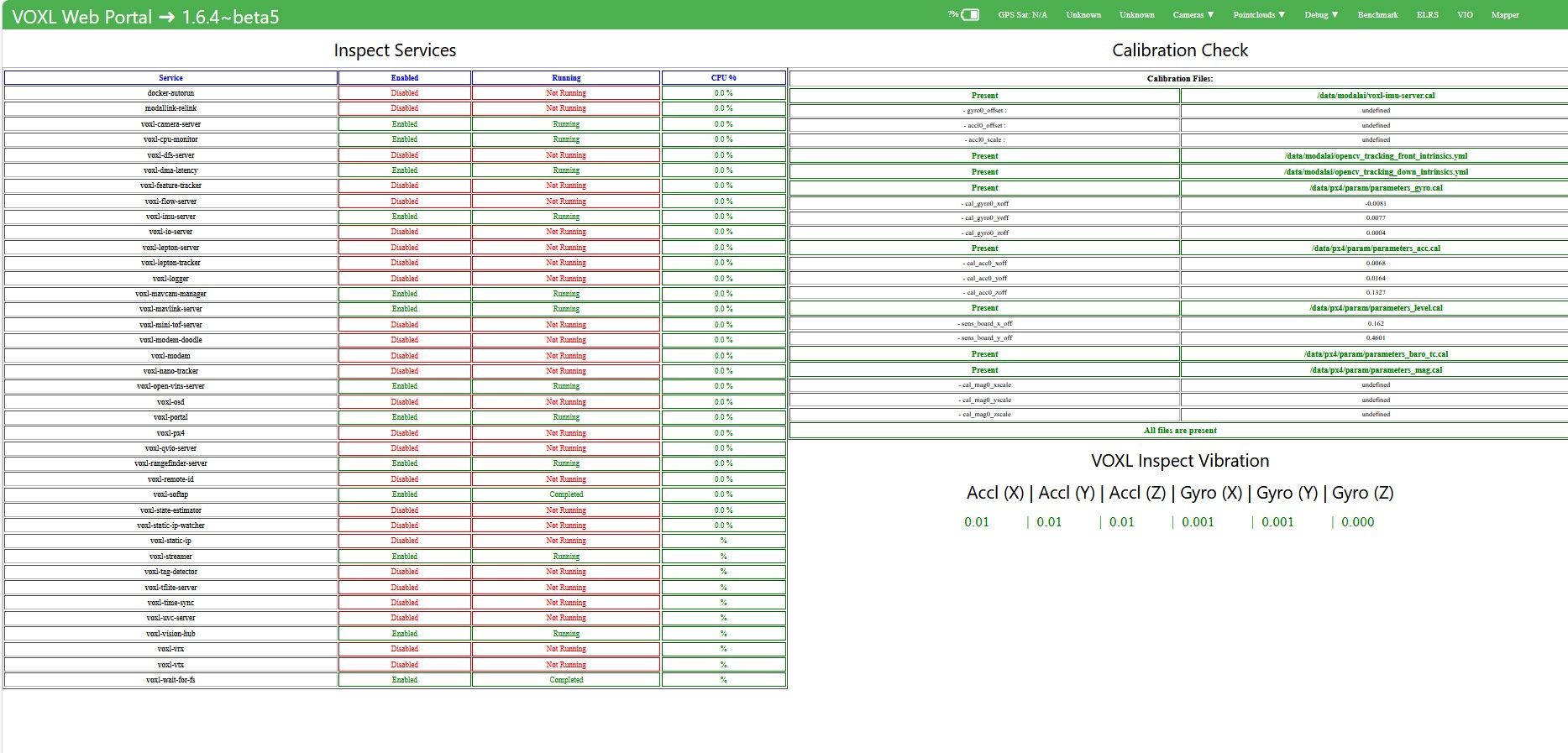

          Hello Ben Linne, thank you for your reply. Our current remote control is running ELRS version 4.x.x and 2.4Ghz
          Which remote control is compatible with the M0184 receiver right out of the box?
          Is it normal for these services not to be running?
          Ben LinneB 1 Reply Last reply

            Any elrs radio that's 900mhz or dual band compatible should work when in low band mode. If the transmitter is running v4+ you should be able to downgrade it to v3 following the elrs update guide
            It's normal that some services aren't running. You may need to re-enable px4 with systemctl enable voxl-px4
