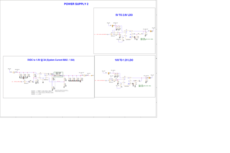

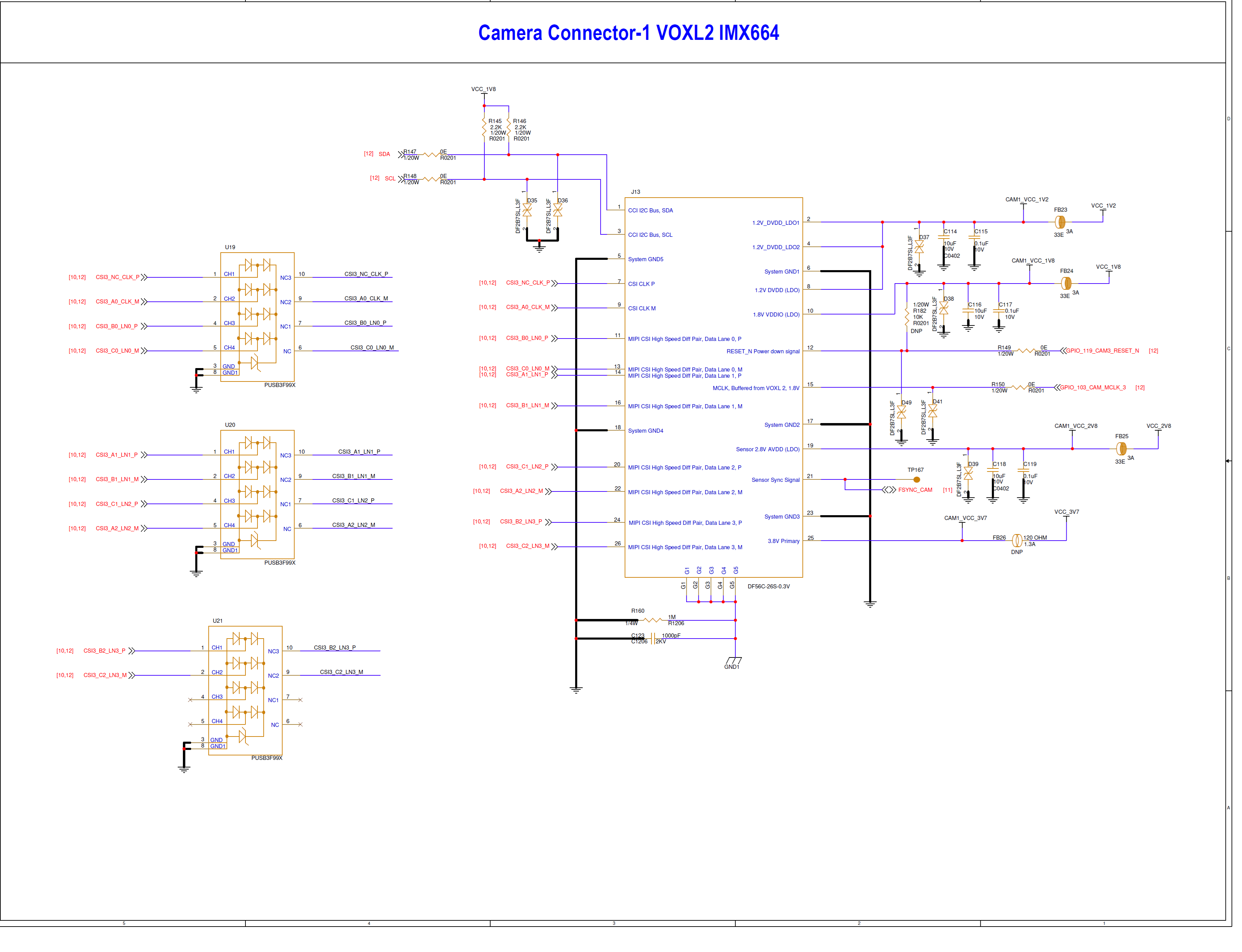

    We are designing one carrier board and wanted to use Camera module MSU-M0186-1-09
    Here, I am attaching schematic image for your reference.
    Let me know if more details are needed.
    Awaiting for your valuable feedback on the same.
