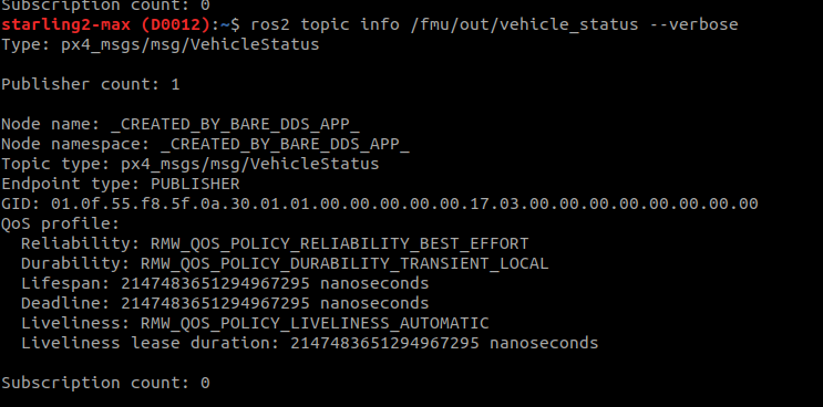

    Dear Researchers and Developers,
    I can see PX4-related ROS 2 messages even without explicitly running any ROS 2 nodes myself.
    It looks like these messages are visible under ROS_DOMAIN_ID=0.
    Could you please share guidance on how to change the ROS 2 domain ID for these PX4-related messages?
    A 1 Reply Last reply

        @ApoorvThapliyal
        Thank you for the reply.
        Did you happen to add export ROS_DOMAIN_ID=1 to your ~/.bashrc?
        When I do that, ROS 2 topics disappear in the VOXL shell.
        However, on my laptop where ROS_DOMAIN_ID=0, I can see the ROS topics.
        That’s why I posted this.

            @ApoorvThapliyal
            Thank you again for the reply!
            We are setting up a multi-robot system, so we are using ROS_LOCALHOST_ONLY=0.
            For example, we want to set the ROS_DOMAIN_ID of drone 1 to 1 and the ROS_DOMAIN_ID of drone 2 to 2.
            However, for both drones, PX4-related messages still appear under domain ID 0.
            Have you tried this with two or more drones?

              Hey @yunwool
              Just to be clear, consider only your first drone, if you run export ROS_DOMAIN_ID=1, then run ros2 topic list, you aren't seeing any topics right?
              After you set the ROS_DOMAIN_ID of a drone to 1, to get the PX4 topics to show up, on QGC > Analyze Tools > MAVLink Console, run the following commands:
              param set XRCE_DDS_DOM_ID 1
              param save
              Then power cycle the drone, give it like 15s after boot up, then the topics should come up directly when running ros2 topic list on that drone.
