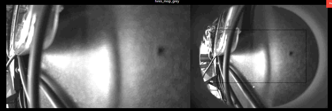

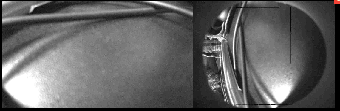

    Hi! I'm noticing some difference in functionality when I switch eis_mode from horizon-level to full-follow.
    I built voxl-camera-server off the eis branch and followed the instructions. everything seems to be working correctly including stabilization other than the final output rotation that I am looking for.
    My imu_apps to hires extrinsics are set up correctly and I want to apply this additional transform to the output:
            "parent": "hires",
            "child":  "hires_eis",
            "T_child_wrt_parent": [0.066, 0.009, -0.012],
            "RPY_parent_to_child":    [0, 0, -90]
    I'm noticing that if I set "eis_mode": "full-follow" the transform isnt applied but if i set "eis_mode": "horizon-level" it rotates the output window as expected. Here's what I see on voxl-portal when I switch eis_mode and leave the extrinsics file untouched.
    "eis_mode": "full-follow":
    "eis_mode": "horizon-level":
    Hoping to find a way to get the output rotation working in full-follow mode. Thanks!

      @SKA , I thought i fixed that issue a while ago, let me double check. Are you using voxl-camera-server from eis branch or an official release from an SDK?
      S 1 Reply Last reply

        @Alex-Kushleyev I'm building from the eis branch not the official release. Thanks!
        (Note: The images I included in my post are labeled backwards. first image is "eis_mode": "horizon-level" and the second image is "eis_mode": "full-follow")
          @SKA , OK, so what you are saying is that in full-follow mode, the rotation parameter in the extrinsics hires -> hires_eis for the -90 degree rotation is not respected, correct?

            @Alex-Kushleyev yes, that's correct!
