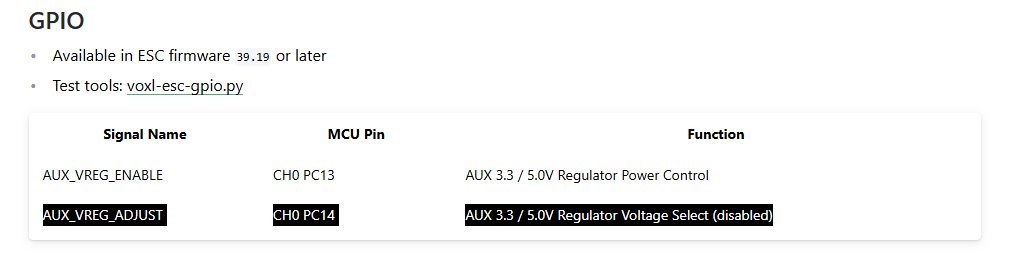

        It's shown here:
        https://docs.modalai.com/voxl-mini-esc-datasheet/#gpio
        Hope this helps!!

          I'm having trouble figuring out the command based off the informatino.
          I tried the command with --id 14 --val 1 ... and also --val 0, but neither make the output 5V.
          I'm connecting directly to the ESC via a USB to Serial adapter and the command finds the board and is able to send the command.

              Alex Kushleyev ModalAI Team @Vinny
              @Martin-Lukac ,
              Yes, we have the capability on the M0129 ESC to enable 5V AUX output instead of 3.3V. The reason why this has not been exposed to the users is to avoid a situation where a user has a 3.3V device plugged in, but the ESC outputs 5.0V.
              Just to clarify your needs - do you need the output to be always 5V and for it to turn on as soon as the ESC boots up? or do you want to turn it on using GPIO (off or on 5V)?
              We have two options, which we have been going back and forth internally:
              • add a new ESC config param to specify the VAUX voltage (off, 3.3V, 5.0V) and whether it should be on after ESC starts up (the defaults would be 3.3V and ON after power up).
              • enable gpio control of the pin that actually controls the VAUX setting (3.3V or 5.0V), so that users can change the output voltage via UART commands
                • this seems not practical, since if you have a device that's plugged in, it could get 3.3V first until you enable 5.0V output.
              Since it is unlikely that someone would need to switch between 3.3V and 5.0V while the ESC is ON, we will probably go with the first option - add a param for voltage after start-up and still allow to tun the regulator on/off.
              Please let me know your thoughts.
