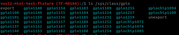

      I'm trying to connect a serial device to J19 (Pin10, 11)
      voxl-gpio read 179
      ERROR:   Failed to open path /sys/class/gpio/gpio1279/value
      I don't see GPIO 178 and 179 on my system:

          Alex Kushleyev ModalAI Team @psafi
          @psafi , before calling voxl-gpio read, you need to enable the pin by setting it to input or output. Please check voxl-gpio -h. (hint: use voxl-gpio -m / voxl-gpio mode)
