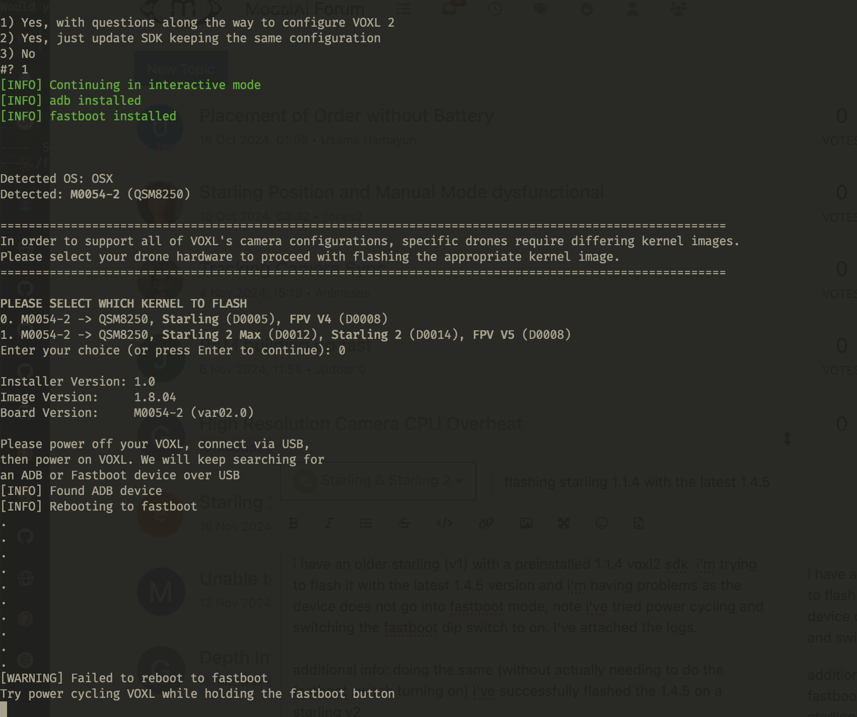

      i have an older starling (v1) with a preinstalled 1.1.4 voxl2 sdk. i'm trying to flash it with the latest 1.4.5 version and i'm having problems as the device does not go into fastboot mode, note i've tried power cycling and switching the fastboot dip switch to on. I've attached the logs.
      additional info: doing the same (without actually needing to do the fastboot switch turning on) i've successfully flashed the 1.4.5 on a starling v2!

              using the dip switch and powercycling there's no devices showing up with sudo fastboot devices.
              unfortunately no lsbusb as i'm under macos, but sysprofiler's output is:
                    Host Controller Driver: AppleT6000USBXHCI
                      QUSB_BULK_CID:0412_SN:008A1847:
                        Product ID: 0x9008
                        Vendor ID: 0x05c6  (Qualcomm, Inc)
                        Version: 0.00
                        Speed: Up to 480 Mb/s
                        Manufacturer: Qualcomm CDMA Technologies MSM
                        Location ID: 0x01100000 / 1
                        Current Available (mA): 500
                        Current Required (mA): 2
                        Extra Operating Current (mA): 0
              if you really think there's some extra info with lsusb that you are looking for i can hook it up to my raspberry pi.
