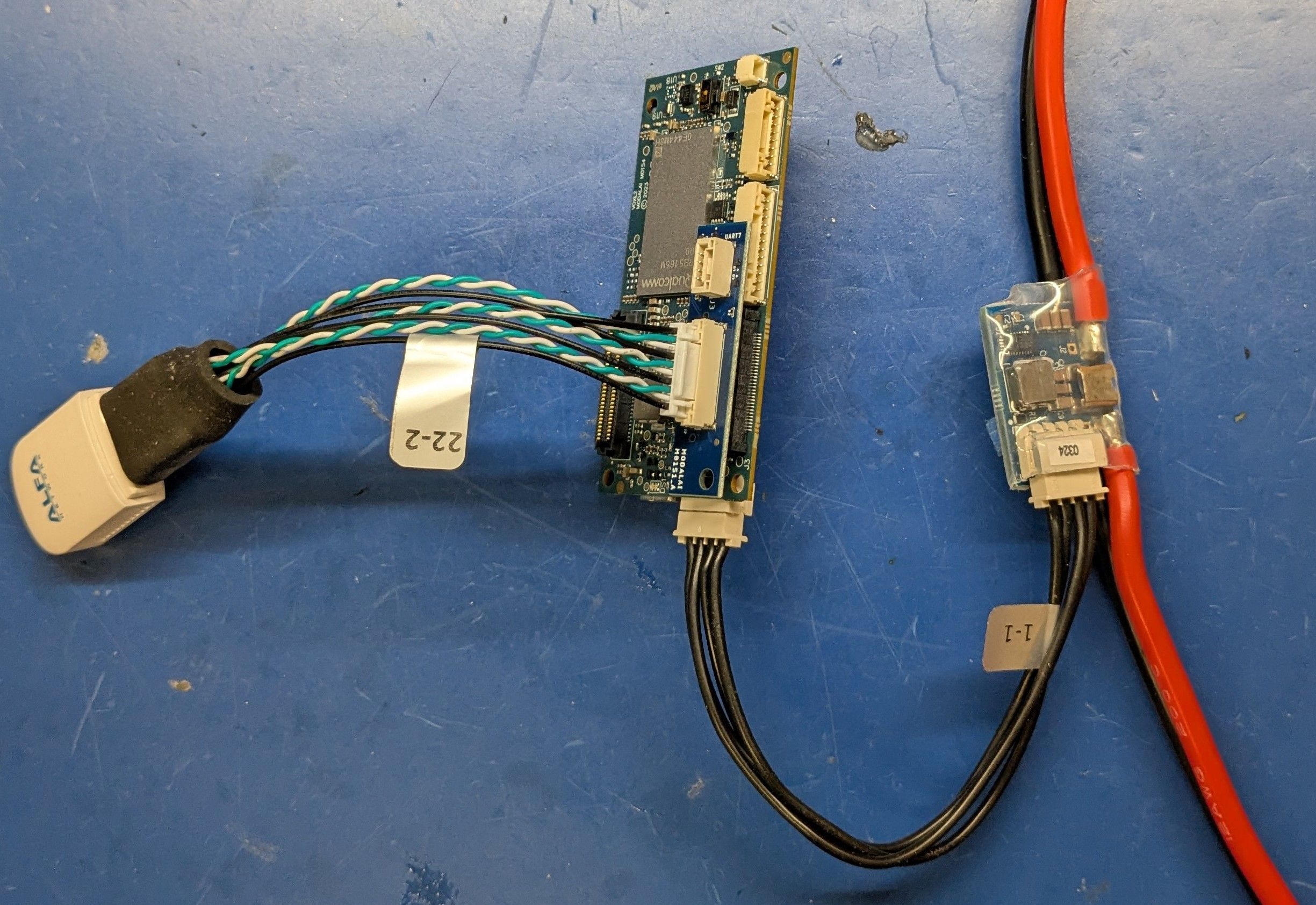

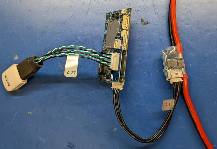

      • tomT
        tom admin @swickliff
        @swickliff Can you post a picture of your setup?
        S 1 Reply Last reply Reply Quote 0
        • S
          swickliff @tom
          @tom At the moment it is just a voxl with the wifi add on. I was going to add the sensors/esc after troubleshooting this issue.
