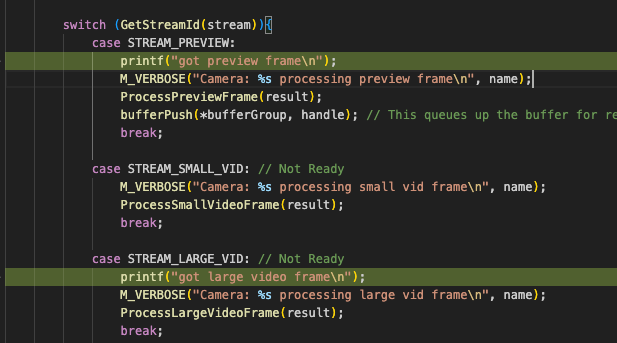

    We at Cleo recently started using the hires large encoded stream.
    We realized that when we started a client for the large pipe, the preview stream results would stop coming through. I confirmed this by adding the following prints
    When I just run the camera server and then voxl-inspect-cam hires_roi I get preview frames, but then when I add a voxl-inspect-cam hires_large_encoded I only get large video and no preview.
    I confirmed that the requests for the preview stream buffers are still being issued.
    We at Cleo need the preview stream at the same time as we need the large stream because we need to stream the ROI to the ground station while simulateously saving the large encoded video to disk.
    Any advice here? Is this a limitation of the ISP and what sort of streams it can provide in unison? Any other way to achieve our requirement of having ROI functionality at the same time as large encoded functionality?

              @Alex-Kushleyev Hi Alex,
              I am assuming that you are using non-raw preview stream (YUV) at resolution around 4000x3000 and similar resolution for the large encoded stream. Then the ROI stream is the downscaled version of the preview stream (please correct me if I am wrong).
              That is correct yes.
              I just tested this setup using IMX412 camera, and using the following branch (which I believe you used as a starting point):
              what camera you are using
              We are using the IMX214, not the IMX 412 - not sure if that would cause a different outcome
              Also try disabling all other cameras and seeing if the issue goes away.
              Only running the hires camera -> the issue persists.
              voxl-camera-server.conf config section for that camera (assuming other cameras do not interfere)
              Other cameras do not seem to impact results. Here is the config entry

                @Alex-Kushleyev Looking at that branch you sent, I might see why you are having better luck than us. We at Cleo only have the code up to and including add roi transition filter to control command; re-enable publishing of preview...
                In green are the commits we have in our codebase, in red are the commits we do not have.
                I note that in the commits we do not have you added the option to change the ROI pipe source:
                    enum ROI_SOURCE_STREAM {
                        ROI_SOURCE_PREVIEW,
                        ROI_SOURCE_VIDEO_SMALL,
                        ROI_SOURCE_VIDEO_LARGE
                and default it to
                        roi_source_stream    = ROI_SOURCE_VIDEO_LARGE; //ROI_SOURCE_PREVIEW; //ROI_SOURCE_VIDEO_SMALL // ROI_SOURCE_VIDEO_LARGE
                Perhaps in the code you tried yesterday the ROI source is the large encoded stream, whereas with my version of the code the ROI source is the preview stream. I will try to port over those five most recent commits from your work on ROI that we do not have in our code base and hopefully get the ROI pipe to work well using the large encoded stream, and that will serve as a solution (or rather no longer have the need) to get the preview stream working alongside the large encoded stream. Thank you for your help!!
                          ROI_SOURCE_PREVIEW,
                  and default it to
                  Hi @Rowan-Dempster , I actually tried this branch with both sources for roi (preview and large video stream). It seems to work fine.
                  I did notice that there is a bug where we were not setting the frame id, this needs to be added right here : https://gitlab.com/voxl-public/voxl-sdk/services/voxl-camera-server/-/blob/feature-add-c2d-select-roi-src/src/hal3_camera_mgr.cpp#L1341
                  roi_meta.frame_id     = meta.frame_id;
                  So, please try the code in the branch (with frame id fix) with different roi sources and let me know how it behaves. It should not matter whether the camera is IMX214 or IMX412, but i have not tried with IMX214. If this branch has the issue with IMX214 based on your testing, i can try it.
                  Also, if you have not already done so on your branch, please lock voxl-camera-server to use only upper 4 cores, as it significantly improves camera server performance when the load is high (the low level ISP interrupts happen on lower cores only, so this way camera server is not interfering). The reason why i mention this is that you are using an old branch of camera server, so just double checking.

                    @Alex-Kushleyev
                    Is there any reason to use the preview source? I would prefer to leave that stream disabled since we do not need it for anything except (in the past) the ROI pipe (but now that ROI works on the large video source), and we are already using the large video pipe for recording videos.
                    Yes we have the voxl-camera-server locked to 4-7:

                      @Rowan-Dempster, one reason would be if your video recording resolution is lower than full camera resolution, but you may want the input for ROI to be the maximum resolution (so you get the best zoomed in quality). So in this case you would set your preview resolution to the max (and use preview as input to ROI) and then your video stream would record the downscaled full view.
                      If your video recording resolution is already at maximum, then there would be no benefit in using a preview stream for this use case.
                      Depending on the use case, you can choose what works better for you.
