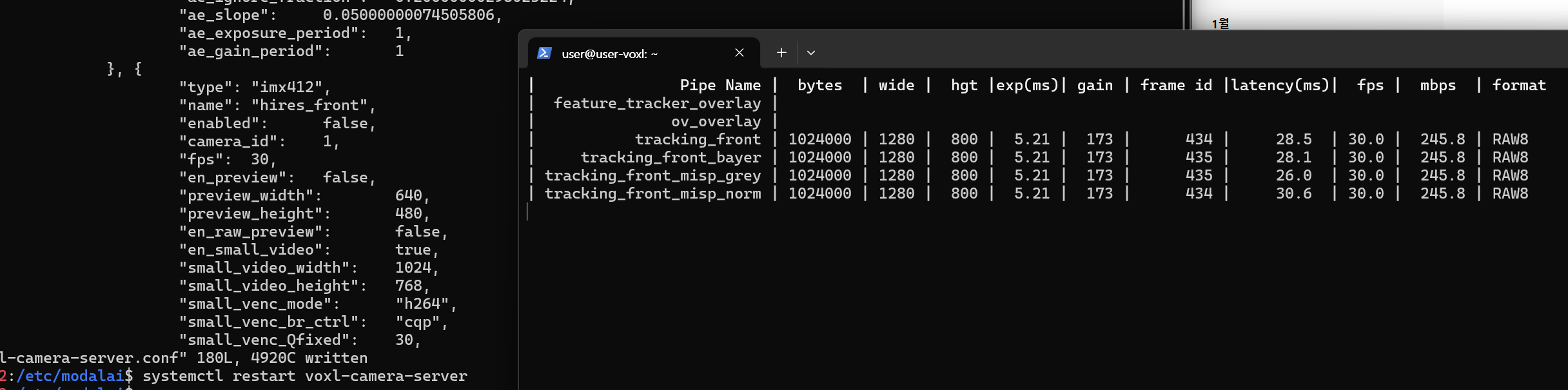

        I have currently set it to C28 and have installed tracking cameras on the front and rear.
        However, if I disable the remaining cameras, tracking down does not run.스크린샷 2025-02-26 162842.png

          @tkddnjs825 ,
          Can you please run “voxl-camera-server -l” and look at the very top to see which cameras have been detected (this is regardless of what you enable in camera server config). We first want to make sure all the cameras are correctly detected (should be 4 cameras). You could past the first part that lists detected cameras, their ids and slot numbers.
