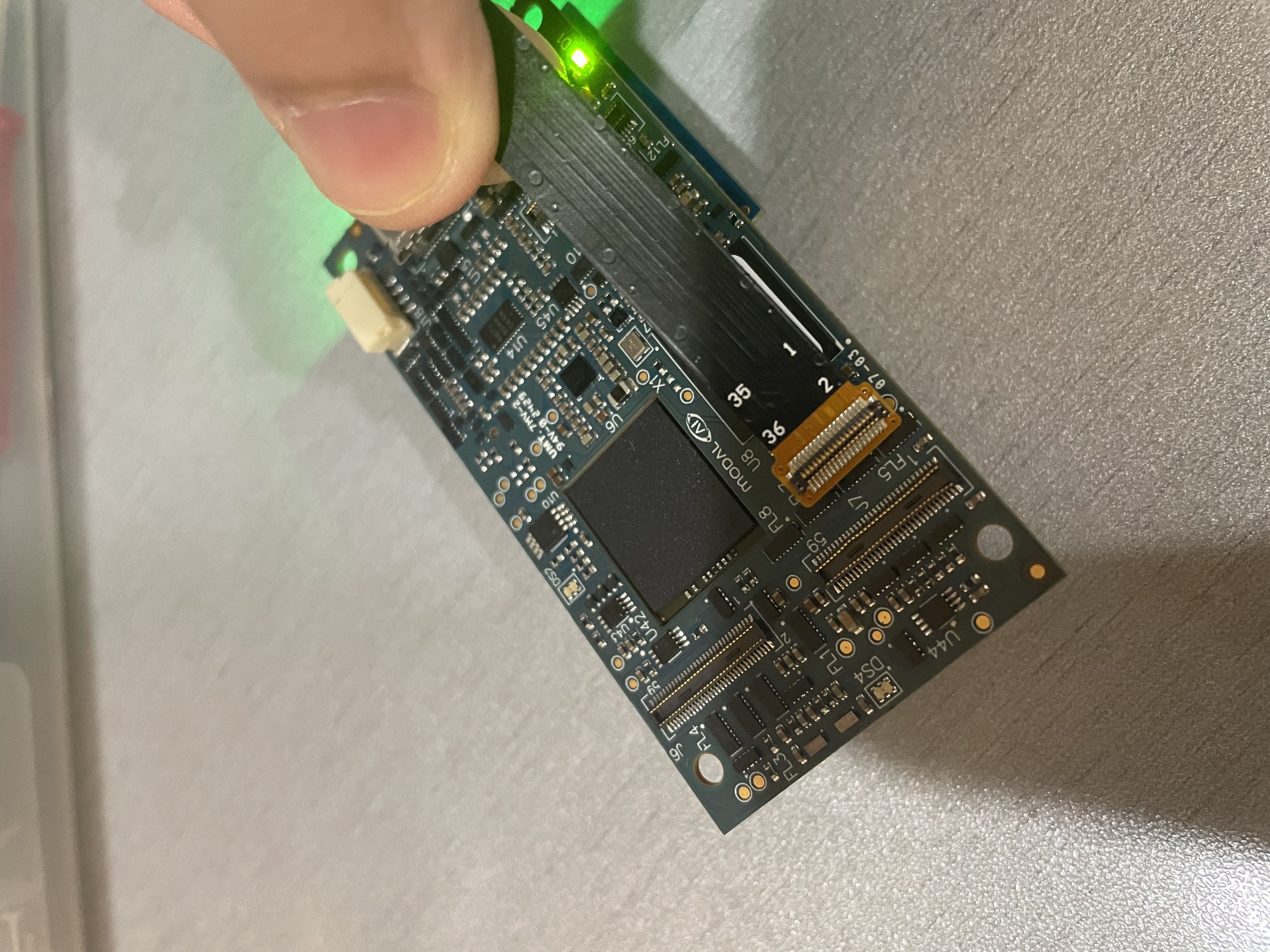

      I've just purchased my very first Voxl 2 and Tracking Camera. I'm trying to connect the Tracking Camera to the J7 port on the Voxl 2 board, but the connectors don't seem to match. The product page doesn't mention a need for any additional connectors. Am I able to just connect the Tracking Camera into the port or will I need an additional connector. If it's the former, how do I connect it since the documentation isn't very clear? If it's the latter, what additional connector will I need to purchase? I'm attaching a picture of the Tracking Camera connector and the pins on the Voxl 2 that I'm trying to connect it to. Additionally, the pins seem to be a bit bent. Is this going to be an issue?

        @Maanav-Iyengar you need an Image sensor interposer to connect the Camera sensor to the VOXL2 board.
        check out: https://www.modalai.com/products/mdk-m0076-1
        Maanav IyengarM 2 Replies Last reply Reply Quote 0

          @Jetson-Nano Thanks, sounds good! I'll purchase one right away. Do the pins on my Voxl 2 board look okay because they appear bent?
          Jetson NanoJ 1 Reply Last reply Reply Quote 0

              @Maanav-Iyengar The J7 PORT pins appear bent for some reason. J6 appears fine.
