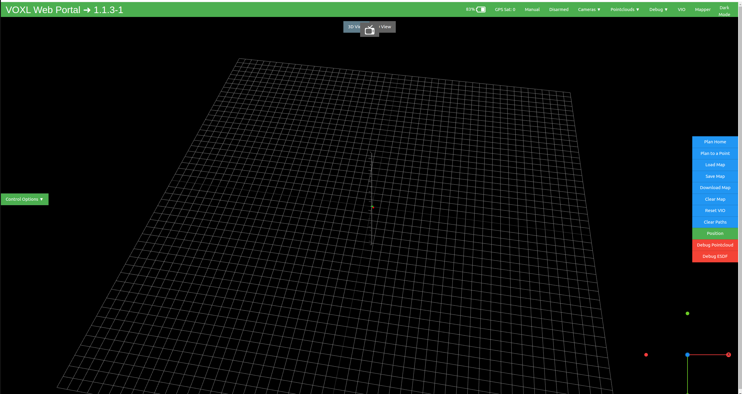

    Hello, I am struggling to access pointcloud data from my newly purchased Sentinel Developer Drone.
    If I go to the Voxl Web Portal and go to pointclouds -> voa_pc_out I see nothing.
    cd34e5b9-0dd3-4802-8ce4-00196a79fc28-Screenshot from 2024-04-02 10-47-14.png /home/speeep/Pictures/Screenshots/Screenshot from 2024-04-02 10-47-14.png
    Same with going to Mapper. Also blank.
    f3fa17cd-d744-403f-88e2-07e343deae54-Screenshot from 2024-04-02 10-48-09.png /home/speeep/Pictures/Screenshots/Screenshot from 2024-04-02 10-48-09.png

      NEVERMIND! I resolved the issue. Just had to do a systemctl enable voxl-dfs-server and then powercycle the drone. Hope this helps anyone in the future.
