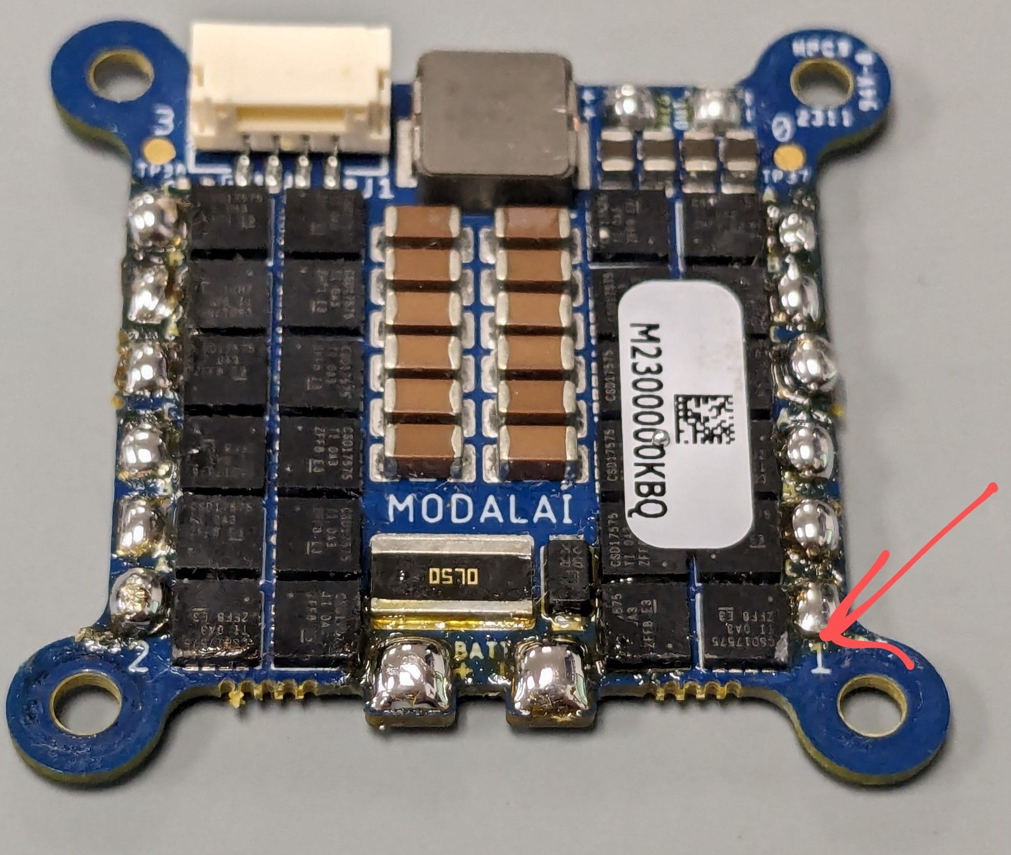

          There is a small chip on a mosfet on the ESC channel. That is the only visible damage I can see on either side of the board.
            Alex Kushleyev ModalAI Team @swickliff
            @swickliff , thanks for the details. The red arrow is pointing to a Mosfet, it looks like it is chipped. That may or may not explain the motor whistling noise (i have had chipped mosfets that were working fine), but since the LED is not working, there maybe other mechanical damage on the other side. Since you mentioned that you do not see any other damage, the issue could be a broken connection between the MCU and the PCB (this ESC uses BGA MCU package).
            It is possible that during this particular crash, the mechanical stress on the board was enough to break several BGA connections, in which case you would not be able to recover it. That is likely what happened because you are observing multiple issues which are essentially unrelated besides being connected to the same MCU (led issue, motor control issue).
