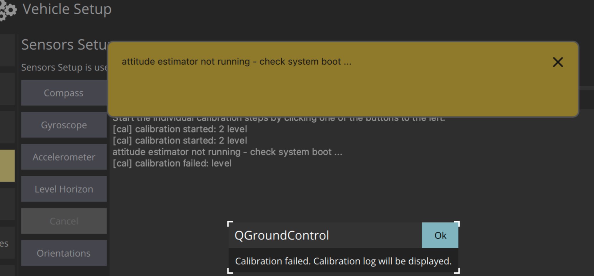

      I had purchased the voxl2 I/O board and got everything hooked up. Upon trying to calibrate the voxl2 over UDP an error "Attitude estimator not running, check system boot" is thrown. I tried using mavlink shell but according to https://docs.modalai.com/voxl2-px4-user-guide/#known-issues-and-limitations this is not available... Could you provide a guide to debugging messages on the flight controller similar to that of mavlink shell / nuttshell.

          The following occurs
          https://imgur.com/a/dftsjQZ
          Apparently the file is too large... i apologize for the link 😕

              @mawriyo ,
              Do you have an external mag/compass or no? I'm thinking maybe not, and if that's the case perhaps EKF2 is looking for mag data....
              I replicated during "level horizon" calibration if the mag is missing:
              In order to proceed without a mag, you can run the following (assuming PX4 is running already, and these commands are in a new terminal):
              # set to NONE
              px4-param set EKF2_MAG_TYPE 5
              # verify
              px4-param show EKF2_MAG_TYPE
