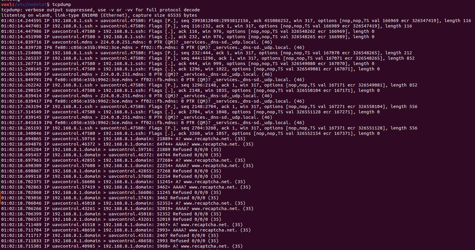

  • VOXL 1 - Seeker Drone Setup with QGC
    N nekolny
    Also this is what I was getting when inspecting the mavlink server.
    00:19:39.969721 IP 192.168.1.1. domain > 192.168.1.134. 40850: 5282 Refused 0/0/0 (42)
    00:19:39.970315 IP 192.168.1.134.48451 > 192.168.1.1. domain: 5282+ PTR? 1.1.168.192. in-addr
    • arpa. (42)
    00: 19:39.973637 IP 192.168.1.1. domain > 192.168.1.134.48451: 5282 Refused 0/0/0 (42)
    00:19:40. 106351 IP 192.168.1.138.14550 > 192.168.1.134.14550: UDP, length 21
    00:19:41. 068099 IP 192.168.1.138.14550 > 192.168.1.134.14550: UDP, length 21
    00:19:41.553204 ARP, Request who-has 192.168.1.1 tell 192.168.1.134, length 28
    00:19:41.553488 ARP, Request who-has 192.168.1.138 tell 192.168.1.134, length 28
    00:19:41.558414 ARP, Reply 192.168.1.1 is-at 80:69:1a:06:84:4e (oui Unknown), length 28
    00:19:41.561634 ARP, Reply 192.168.1.138 is-at 34:c9:3d:07:16:8d (oui Unknown), length 28
    00:19:42. 065376 IP 192.168.1.138.14550 > 192.168.1.134.14550: UDP, length 21
    00:19:43.070712 IP 192.168.1.138.14550 > 192.168.1.134.14550: UDP, Length 21
    00:19:44.075718 IP 192.168.1.138.14550 > 192.168.1.134.14550: UDP, length 21
    00:19:45. 064630
    00:19:46.062935 IP 192.168.1.138.14550 > 192.168.1.134.14550: UDP, Length 21
    00: 19:47. 107960 IP 192.168.1.138.14550 > 192.168.1.134.14550: UDP, length 21

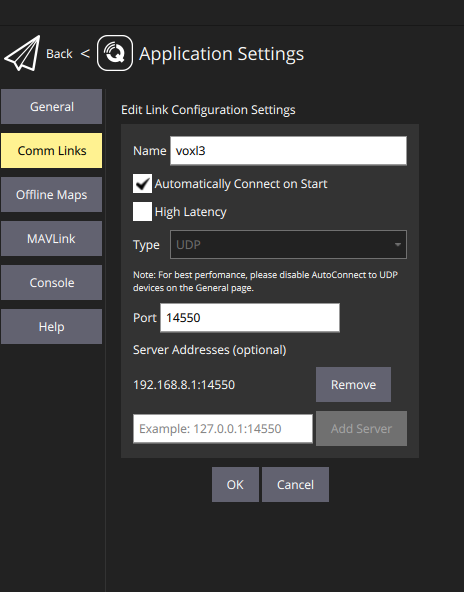

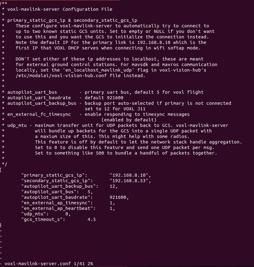

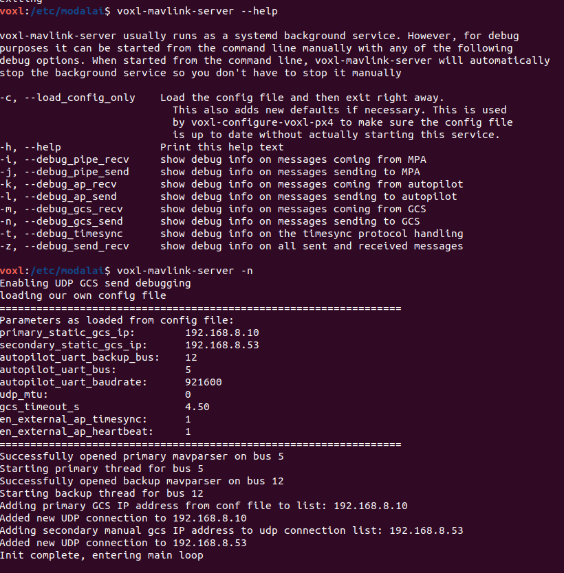

    N nekolny
    Hello everyone following to my previous attempt https://forum.modalai.com/topic/4332/qgc-cant-see-seaker-but-ssh-works/4?_=1745528516727
    I have setup a second drone with newest suported version of VOXL for VOXL 1 board, which is 1.2.0.
    Once system is setup I setup both the mpa, as well as extrinsics, which all suceeds and reports that the drone is seeker drone with the approrpriate cameras. Now with the QGC connection I am using version 4.4.4 on Ubuntu 24. Within the drone I go to /etc/modalai/ directory and find the voxl-mavlink-server.conf file within which i set the secondary ip to the IP of my pc which in the softap mode is 192.168.8.53 with there being no default prefilled field for UDP port but it is sending the defulat connections on 14550 just that the config filoe does not have the UDP port specified. Compared to the prior version 0.9.5 there are no PX4 config files, as well as services which feels weird but unsure if that is supposed to be or not. On PC i start QGC and go to the connection tab, setup a new link, UDP and enter the IP adress of the drone with the Port number.
    Now to the issues:
    1. Sometimes the ADB shell does not detect the drone, the ssh config does work but when connected to the specified port on the drone and running adb shell it marks that there are no devices.
    2. Connecting to the QGC, when running voxl-inspect-mavlink any of the options it sometimes does report: waiting for the pipe to connect
      2.1 When the above commands to produce outputs it is showing and reporting connection to the ground control program but the QGC does show its disconnected and when looking in the mavlink inspect part of qgc it does not show anything.
    3. when running voxl-mavlink-server and then setting to check from MPA or autopilot or GCS i am getting that: init complete entering main loop
      3.1 and some times when the comands do respond i am getting the UDP connection showing packets beign send from drone to the IP, but nothing much sent from QGC.
    Now what I have tried. I tried different veersions of QGC 4.4.0 was the oldest i tried so far. And all show that they are disconnected without any indication of connection. I use separate device connected wither to soft IP or the wifi router to monitor the ip adresses, plannign to try track packets being send but at moment all devices do not change ips. Below i am attching the services running on the drone.
    ![alt text](Screenshot from 2025-04-24 14-06-45.png image url)
    I feel that I am lost as the first drone which was mentioned in the post above, seems to be bricked with me not seeing it in adb either, and not being able to flash newer version of VOXL.
    If there are any ideas or potential steps or logs I can provide I will, but at this moment I am ta loss.
    Ask your questions right here! voxl seeker qgc

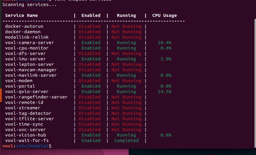

  • QGC Cant See Seaker but SSH Works
    N nekolny
    @Alex-Kushleyev said in QGC Cant See Seaker but SSH Works:
    Link Preview Image
    Connect to QGC
    ModalAI technical documentation for VOXL and VOXL 2 Companion Computers for PX4 and ArduPilot Obstacle Avoidance and GPS-denied navigation, assembled in the USA
    favicon
    ModalAI Technical Docs (docs.modalai.com)
    Thank you very much, I was curious if there are other steps necessary for VOXL 1 board, as I have oone drone updated to 1.2.0 which is the latest VOXl 1 supports, but it does not have any PX4 services. My other drone, which previously worked with flight is the one on 0.9.5, which I plan to also update to 1.2.0. The video provided is helpful but with the commands inspecting mavlink messages, they are absent from the VOXL 1 version, services which I have on the 1.2.0 are.
    docker-autorun
    docker-deamon
    modallink-relink
    voxl-camera-server
    voxl-cpu-monitor
    voxl-dfs-server
    voxl-imu-server
    voxl-lepton-server
    voxl-mavcam-manager
    voxl-mavlink-server
    voxl-modem
    voxl-portal
    voxl-qvio-server
    voxl-rangefinder-server
    voxl-remote-id
    voxl-streamer
    voxl-trag-detector
    voxl-tflight-server
    voxl-time-sync
    voxl-uvc-server
    voxl-vision-hub
    voxl-wait-for-fs
    there are no px4 files within /etc/modalai
