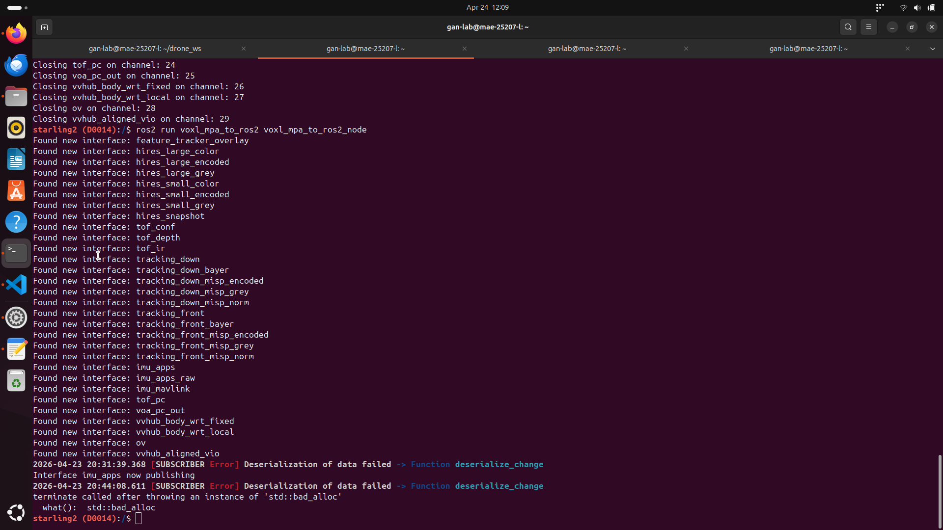

            • AniruddhaA
              Aniruddha @ApoorvThapliyal
              @ApoorvThapliyal I was trying to echo /imu_apps
              • AniruddhaA
                @ApoorvThapliyal I forgot to mention that the error occurred on drone side for voxl_mpa_to_ros2_node. While on computer it is not printing anything
                A 1 Reply Last reply Reply Quote 0

                  • AniruddhaA
                    @ApoorvThapliyal
                    This is how its being showing
