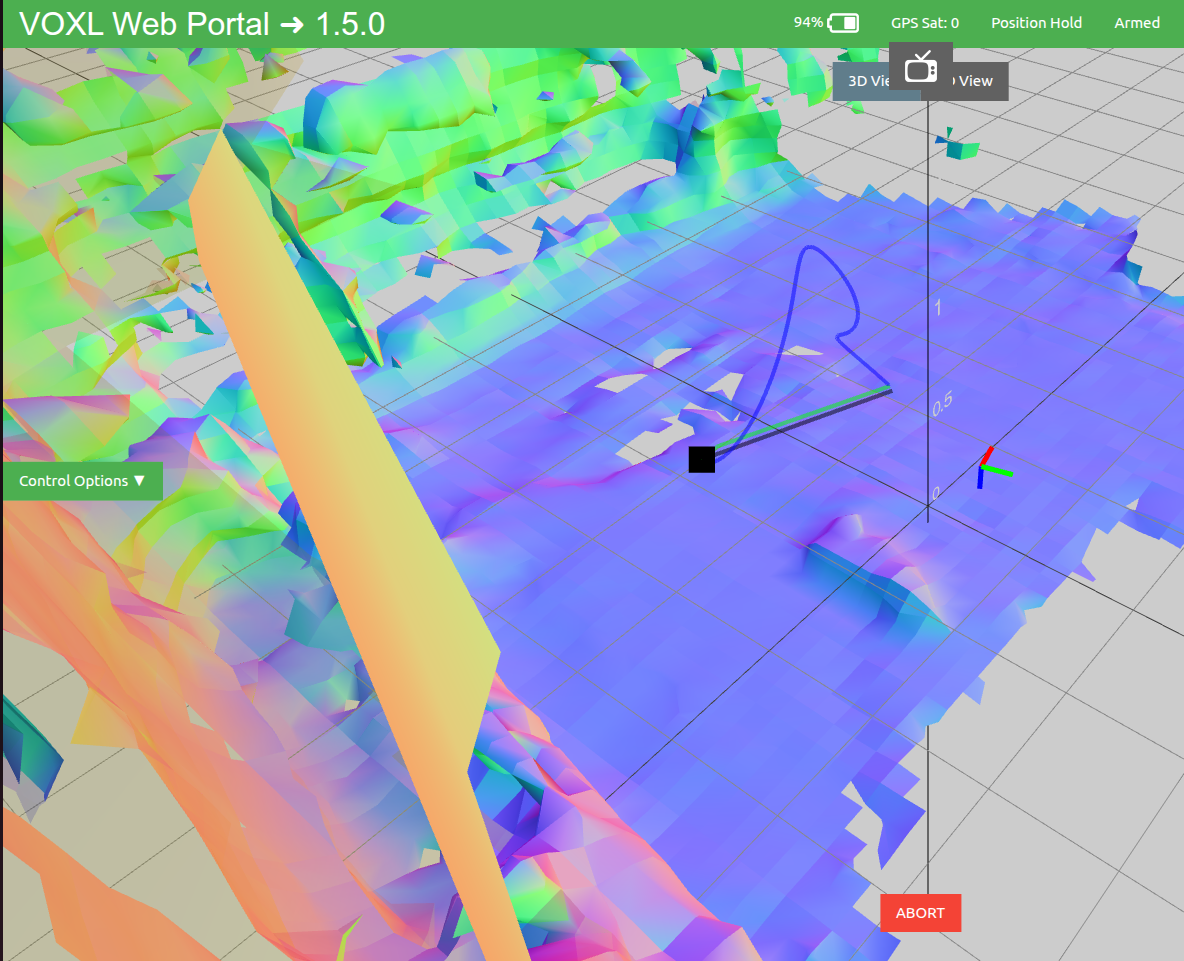

      I am having significant issues with the voxl-mapper on a Starling drone. When using the "Plan to a Point" feature in the VOXL Web Portal, the system fails to calculate or execute a reliable path.
      Even in a clear environment, after clicking "Plan to a Point", the calculated trajectory (blue line) becomes erratic. Instead of following the direct path, the drone often moves to incorrect locations, diverges from the intended target, or the planning simply fails to produce a viable route.

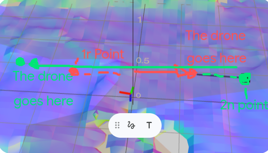

                • D
                  DronAlan @DronAlan
                  Now he's doing it the other way around, I don't understand anything
                  Cliff WongC 1 Reply Last reply Reply Quote 0

                    @DronAlan Hi there,
                    Seeing the opposite direction that looks like a 100% 180 rotation is typically a sign of a reset while powering up: incorrectly detects the gravity vector. This is a common anomaly with qvio. I suggest at power up, immediately put the drone on the ground and try not to move the drone until takeoff. Try this and see if you get consistency. QVIO is sensitive to resets prior takeoff. You can edit the following in /etc/modalai/voxl-vision-hub.conf:
                            "en_reset_vio_if_initialized_inverted": false,
                    if your use case doesn't allow this type of procedure, you can ssh onto the drone and force reset before every takeoff by running: systemctl restart voxl-qvio-server.
                    If you have not edited the extrinsic settings from factory then I would safely assume they are correct, but in case, extrinsics are stored in /etc/modalai/extrinsics.conf where you'd look for the body to imu parameter section (which should be 0,0,0 in starling's case).
                    Note: these types of anomalies have been corrected in SDK 1.6.x, as the latest SDK now defaults to the new & improved openvins VIO subsystem if you're inclined to upgrade (recommended, though any custom-external apps make need to be recompiled as the MPA API has changed).
                    D 2 Replies Last reply Reply Quote 0
                                I am experiencing a severe issue with trajectory execution in the SLAM/Mapper mode where the drone exhibits an inverted and cumulative 'mirror' behavior regarding position setpoints.
                                As shown in the attached image:
                                1. If I set a first waypoint directly in front of the drone (1st Point), the drone flies backward instead, covering the intended distance but in the exact opposite direction.
                                2. From that new incorrect position, if I command the drone to return backward by the same distance (2nd point, aiming to return to the original starting location), the drone does not return. Instead, it flies forward, doubling the distance in the opposite direction from the newly commanded point.
                                It appears as though the drone is accumulating a starting error or interpreting the coordinate frame in a completely mirrored way (FRD vs NED mismatch), where both the direction and the origin reference point are inverted. The dashed lines in the image represent the intended path, while the solid arrows represent the actual path flown. I am on SDK 1.6.3 with factory settings.
                                • Cliff WongC
