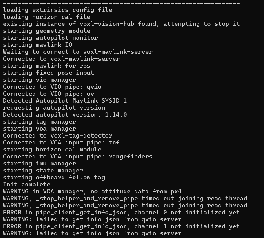

            I tried voxl-vision-hub --debug_fixed_frame while showing AprilTag to the tracking camera with different orientations, but got some warnings about qvio.
            Since this was a warning about qvio, I checked voxl-inspect-qvio, and it was working okay.

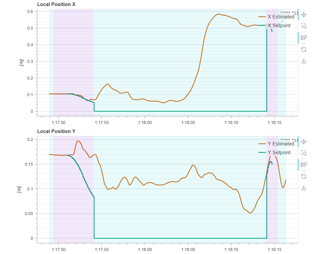

            I tried to operate it without propellers and got the following logs in PX4.
            The set points appear to be at the origin instead of those defined by AprilTag. Can you please help me with this?

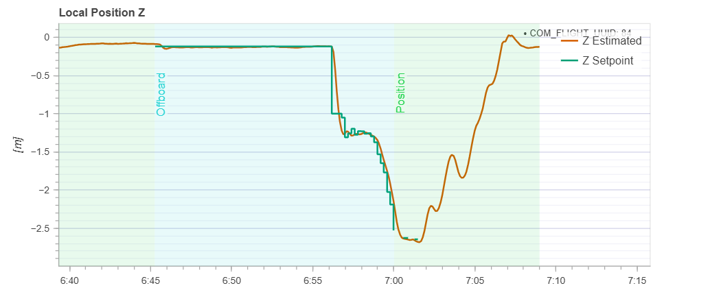

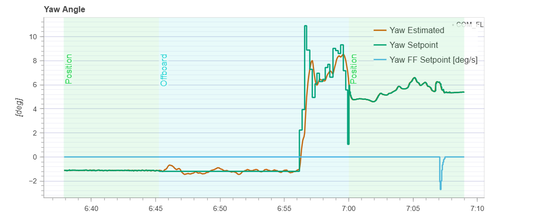

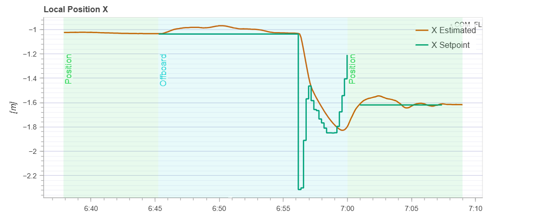

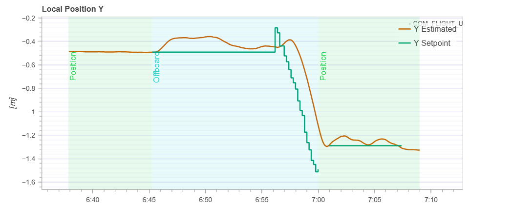

              @ApoorvThapliyal, with the setting you provided, I tried flying with propellers on in offboard mode. Once I armed and switched to offboard mode, the drone took off and stayed at around 10 cm height for 10 seconds. During that time, it didn't detect AprilTag and failed to align, as the height was too low for detection. However, after 10 seconds, it suddenly began to gain height, and as it approached the ceiling, I took control and landed. From the log file, we can see that the drone was attempting to align its X and Y positions with AprilTag; however, the issue was that the Z setpoints continually decreased. Can you please help me solve this?
              Additionally, it would be more beneficial if we could run it using MAVSDK and customize it for our specific code.
              0a5ae7d1-78ab-459d-aca4-123cdf9555c7-bokeh_plot (3).png 74c3a513-d3fc-457c-a255-5661358c913f-bokeh_plot.png 81823e36-b956-4946-9e43-738052a44012-bokeh_plot (1).png 5a5753ea-ac3e-427c-b9ff-d2f8903adf88-bokeh_plot (2).png
              A 1 Reply Last reply Reply Quote 0
              • A
                ApoorvThapliyal @Rupesh
                @Rupesh Apologies for the late reply
                It looks like there’s an issue with how the AprilTag system is relocalizing the drone. In my tests, the z-value appears to be misinterpreted, which could explain why your drone was climbing in altitude to correct its height estimate. We’re actively working on a fix.
