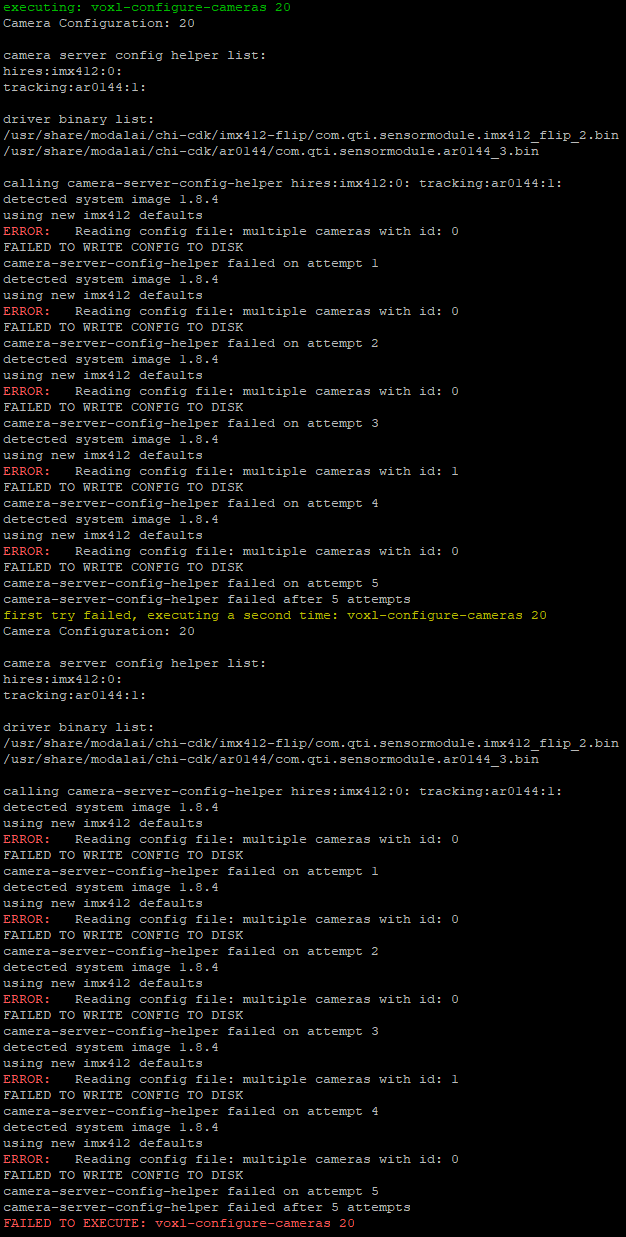

      We are getting an error when writing configs to disk.
      I assumed that it was an issue with writing data to a partition in memory that was not allowing a write at that time.
      We are able to resolve it by power cycling, but while in production, it becomes a hang up when putting units together.
      Curious if there are commands (ex: sync) or things that we can do to get rid of this behavior. Thanks!
      • tomT
        tom admin @wilkinsaf
        @wilkinsaf I believe this issue was fixed in this commit: https://gitlab.com/voxl-public/voxl-sdk/services/voxl-camera-server/-/commit/eae04e288cf477014fdf0497bf87595fd7d14411
        v2.2.7 of voxl-camera-server (not yet released as part of an SDK)
