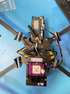

          3. The voxl orientation matches the voxl 2 flight deck, with the picture below the front is the voxl side going to the top of the image
