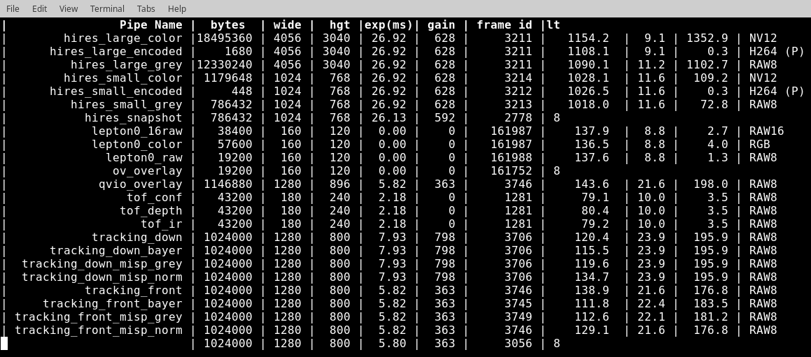

            3. Can you share your output from voxl-inspect-cam -a to make sure your stereo cameras are setup correctly? I would debug this on voxl-portal before moving onto the ROS portion. Do you have tracking cameras setup, and will you be running openvins or voxl-qvio-server. Once that's verified check that you're seeing that pose on voxl-mapper. You should see the orientation show up like in the red box in the picture below or by running voxl-inspect-pose -l.

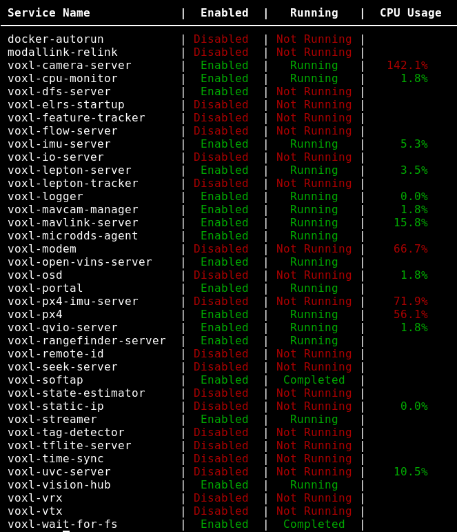

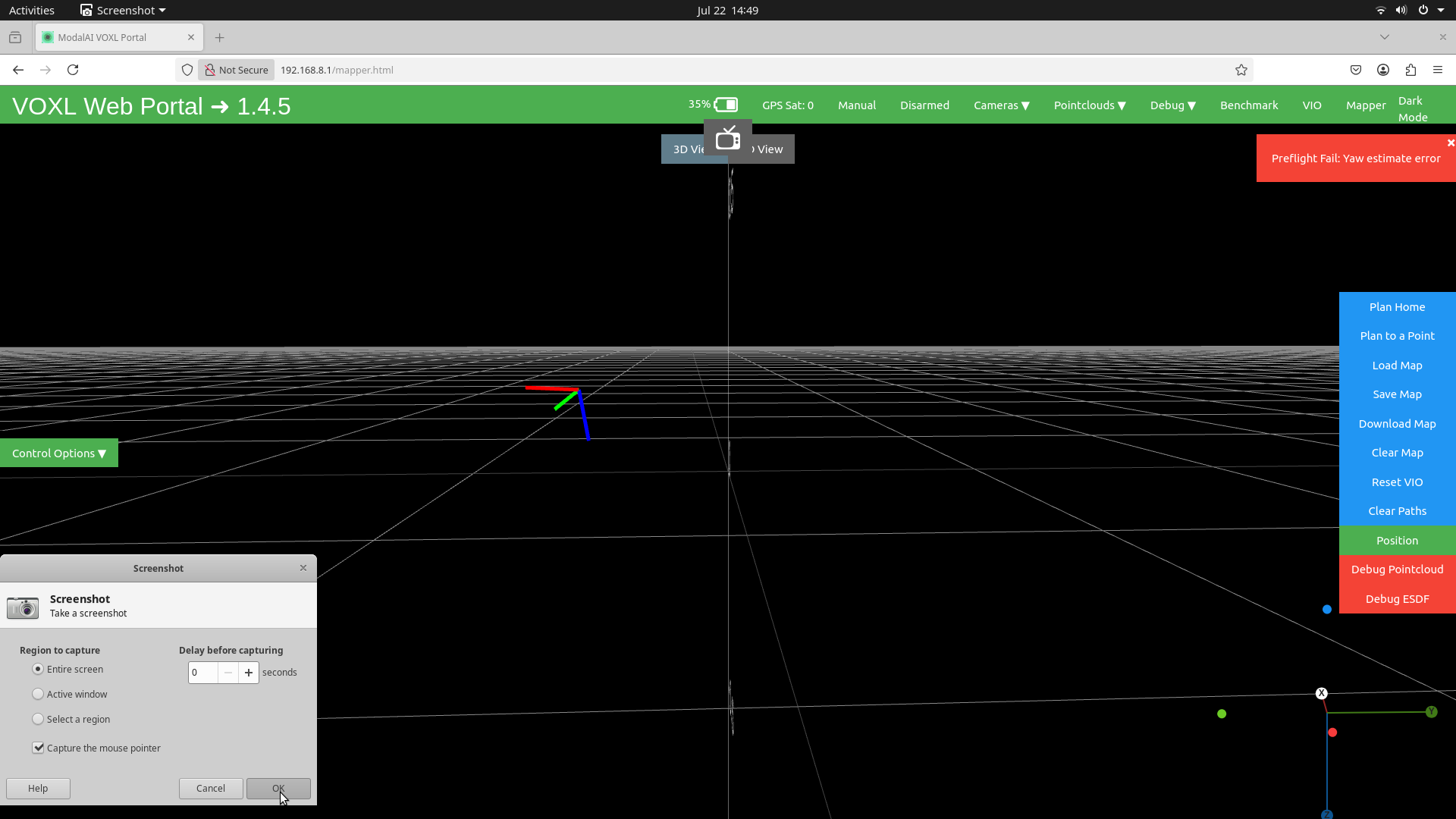

              1. Screenshots are attached below. On the voxl portal, I'm able to see the tracking_down and tracking_front feeds, but I don't see the tracking_rear option (my Starling2 is in C27 config: 1 hires camera, 1 tof sensor, 3 tracking cameras). I haven't changed anything related to the default camera setup, except adding a Lepton 3.5 sensor. I was hoping to use the voxl-qvio-server, but I'm happy to explore openvins if that's more feasible. I don't see a red box, but I'm able to see the axes on the voxl mapper page, and its moving when I move the UAV.
                voxl-inspect-cam-a.png voxl-mapper.png voxl-inspect-pose.png voxl-inspect-services.png
              2. How can I access the voxl_mapper_aligned_ptcloud?
              Thanks,
              George
              T 1 Reply Last reply Reply Quote 0

                Hi @george-kollamkulam,
                That looks good except voxl-mapper doesn't look like it's installed or running. You can install it using the command below. Make sure your starling is connected to wifi else you can adb push the voxl-mapper deb.
                $ wget http://voxl-packages.modalai.com/dists/qrb5165/sdk-1.5/binary-arm64/voxl-mapper_0.2.3_arm64.deb
                $ dpkg -i voxl-mapper_0.2.3_arm64.deb
                After it's installed and running check that you see the map updating on portal and you should see the voxl_mapper_aligned_ptcloud pipe show up as a ros topic.
