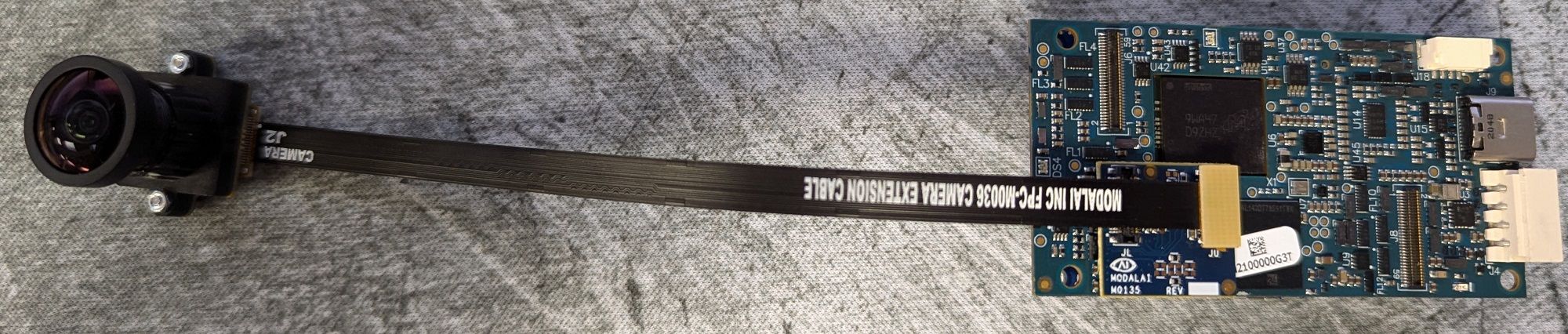

        PXL_20241118_174146798.jpg Alex,
        Currently using the following Config:
        M0107 -> FPC-M0036 Cable -> M0135 Upper Port -> J7 Port.
        Using the same setup as in the M0107 Product Page.
        Tried various setups, however, it does not see any camera connected to the VOXL2.
