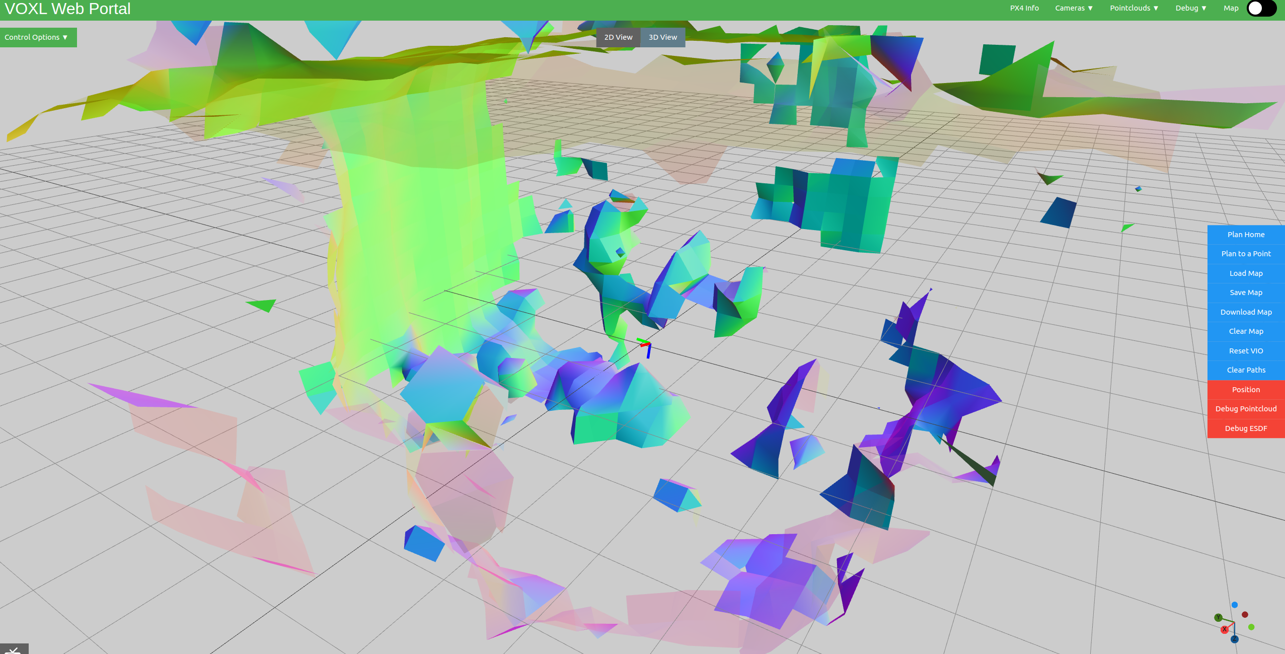

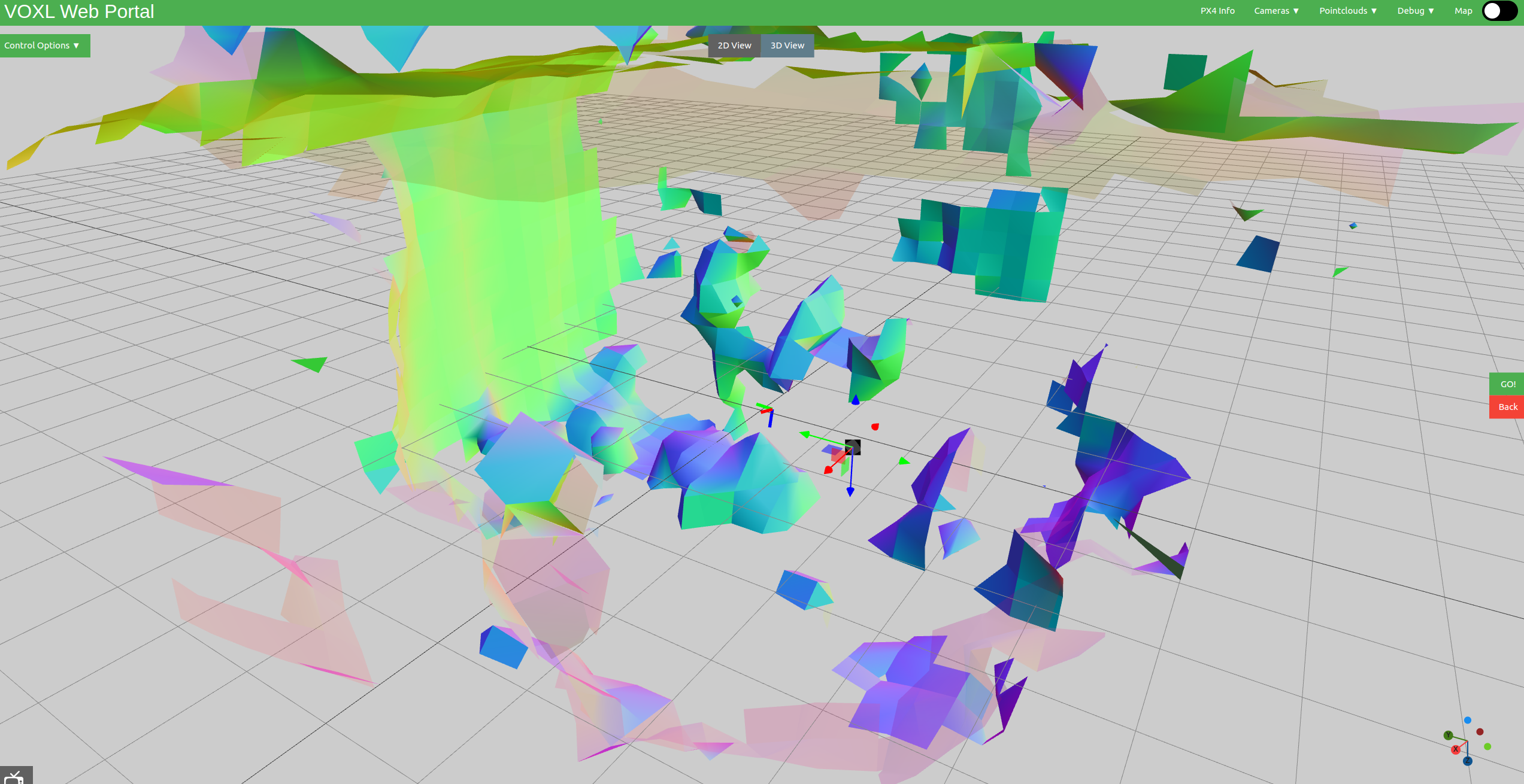

    No trajectory is being shown in voxl-mapper after selecting Go
