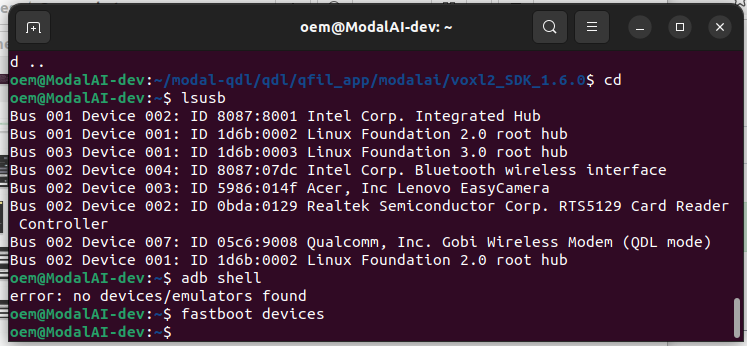

      I attempted to do yet another unbricking only to discover that I couldn't communicate with it via USB. adb shell returns no device found and putting it into fastboot (presumably) and fastboot doesn't detect a device either. The only way I see the device is with lsusb or the web interface shown below.Screenshot from 2025-11-06 15-11-45.png
      I find it interesting that it can be detected but not respond to external commands - the lights are on but nobody is home.

        I've just received the voxl2, so not a lot of experience with it. Just for me to understand-- why not try to unbrick it with the qdl webUI, as it is the only tool that detects it? I'm asking since I have the my board at the same exact state, but this webUI tool failed, so I'm wondering if you know something that I don't (like whether seeing the device via fastboot is a prerequisite for the unbricking).
        R 1 Reply Last reply Reply Quote 0
        • R
          roy.crosthwaite @N. Chen
          @N-Chen I tried the webUI and the command line and as near as I can tell the webUI uses lsusb (or something along those lines) to detect the presence of the board. The install.sh uses adb or fastboot to detect the board and will sit waiting until the board is detected or CTL C is sent. My guess is the usb controller interface is alive and reporting but everything beyond it is dead.
