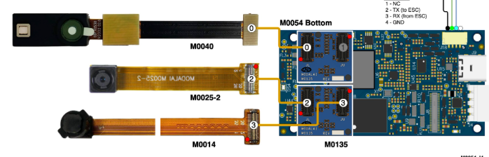

      @Leo-Allesch , please double check that all your cameras are connected as shown in the diagram on this page : https://docs.modalai.com/voxl2-d0005/ (and double check the pin1 locations for each camera)
      Can you provide which cameras are detected by camera server (output of voxl-camera-server -l, just the top part)
      Also, please list the complete contents of /usr/lib/camera/

        The drone is wired up according to the diagram, could you explain what you mean by the pin1 location?
        Here is the output for voxl-camera-server -l
        starling (D0005):~$ voxl-camera-server -l
        existing instance of voxl-camera-server found, attempting to stop it
        DEBUG:   Attempting to open the hal module
        DEBUG:   SUCCESS: Camera module opened on attempt 0
        DEBUG:   ----------- Number of cameras: 1
        DEBUG:   Cam idx: 0, Cam slot: 3, Slave Address: 0x00E2, Sensor Id: 0x7750
        DEBUG:   Note: This list comes from the HAL module and may not be indicative
        DEBUG:   	of configurations that have full pipelines
        DEBUG:   Number of cameras: 1
        Here is the contents of /usr/lib/camera

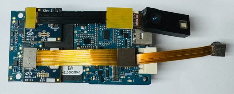

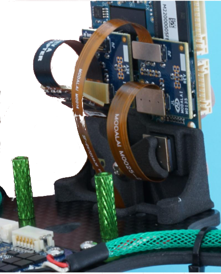

            @Leo-Allesch , sorry for the delay.
            Based on your previous post, only one camera is detected:
            (if more cameras were detected, you would see them show up in that list, which is output of voxl-camera-server -l).
            This is the tracking camera in camera slot 3 (VOXL2 J7 Upper slot). The slot numbers are also labeled in the diagram https://docs.modalai.com/voxl2-d0005/, specifically you can see 0, 2, 3 labeled on the M0135 interposers that are plugged into VOXL2:
            I do see the correct sensormodules in /usr/lib/camera/. (slot 0 for TOF and slot 2 for IMX214).
            I suspect that you have the hires camera and TOF module plugged in backwards into the M0135 adapters. The tracking camera (unfortunately?) has a different connector orientation compared to other cameras, but pin1 is correctly marked with a dot (or a number 1) on all connectors.
            Your cameras should be connected like in the picture below:
            Another look (in the assembly of the drone):
            Please double check the connections.
