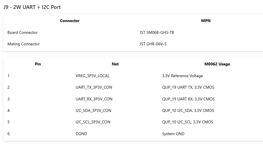

      I'd like to use J9 2W UART + I2C Port on the Ethernet Expansion & USB Hub.
      Does this port include pull-up resistors? Is there a way to control resistance settings? Do you have recommendations/tutorials on how to use this specific I2C port? I have the circuitry / sensors working on bench using Arduino + RPI (I2C master). Trying to port this functionality to VOXL2 being the I2C master.
      Thank you for any advice!

          • VinnyV
            Vinny ModalAI Team @shawn_ricardo
            Hi @shawn_ricardo
            Yes, any I2C port on an expansion board has 2.2K pullups to the voltage on Pin 1 of that connector.
            The Linux Kernel user guide has info on which QUPS are enabled or not in which system image.
            and specifically this helps:
            https://docs.modalai.com/voxl2-qups/
            Note not all QUPs have actually been enabled in the system, but with the sets of ports we have enabled, we never had any customer claim of a shortage:
