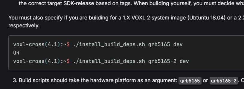

                  bendraper @Eric Katzfey
                  @Eric-Katzfey I tried staging and that ended up working. I was trying dev because voxl-vision-hub repo says to ce8dbcc9-c7a9-4767-80f1-bea728b7e875-image.png
                  • Eric KatzfeyE
                    Eric Katzfey ModalAI Team @bendraper
                    @bendraper I would recommend using dev instead of master. dev is latest, master is an occasional snapshot of dev. However, dev can sometimes be broken so that's always a risk.
                      @Eric-Katzfey dev seems to be broken in that case as I was getting the error
                      /home/root/src/main.c:42:10: fatal error: voxl_vfc_config.h: No such file or directory
