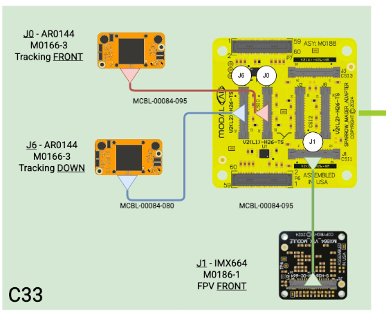

              I have received the M0202 that goes to the M0181 via the pre-installed coax. I also received the M0194. What does the diagram look like with these boards to connect to the M0188 board on the stinger to keep the functionality of the dual tracking camera and front fpv camera? I also received a MCBL-00104-1 usbA to Boson RHP. What is this for?

                @dstylesunf ,
                Please check my post from January, which states that M0188 does not support a Boson sensor and you need M0195 if you want a drop-in replacement for M0188.
                https://docs.modalai.com/M0188/
                https://docs.modalai.com/M0195/
                Can you double check what you have plugged into your voxl2 mini?
                You can remove M0188 and install M0194 (which you have) as another option. You would need to transfer the ucoax connections from M0181 to M0194. The diagram above in this post shows you how to connect Boson and hires camera (essentially a Hadron combo) using M0194 to a voxl2 mini. Do you need more details on this connection?
                If you use the second option, you would lose the dual tracking capability though.
                  With M0195, C34 is the camera configuration that you would need. See https://docs.modalai.com/M0195/#support-camera-configs
