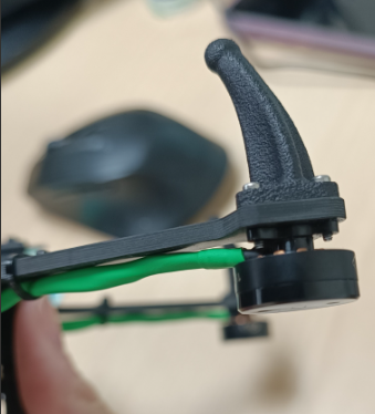

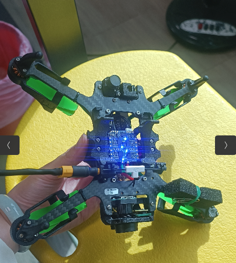

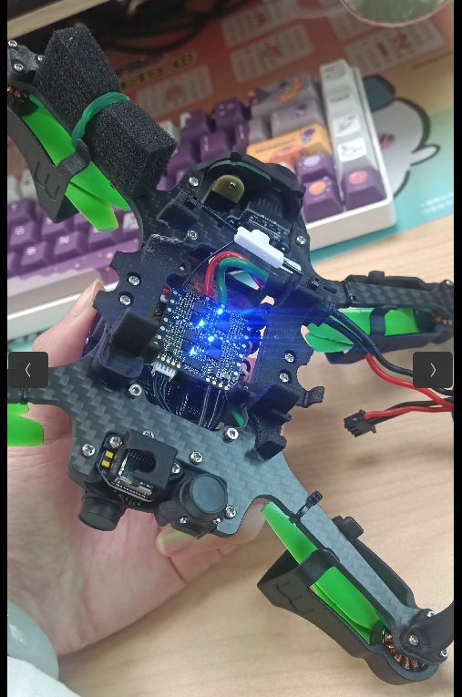

      2. I visually inspected the motor and found no loose wiring or other issues. The LED indicator lights are shown in the image below.

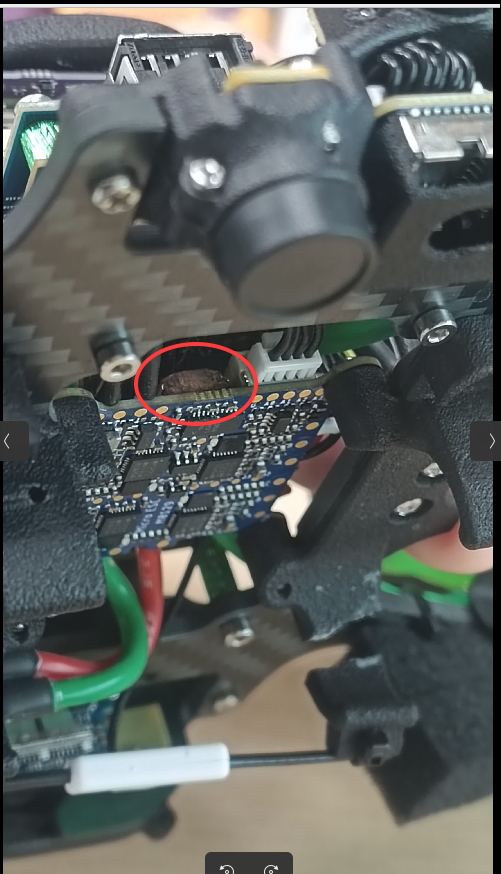

      However, one component on the ESC board appears to be rusty; I'm unsure if this has any impact. Please see the attached image below.

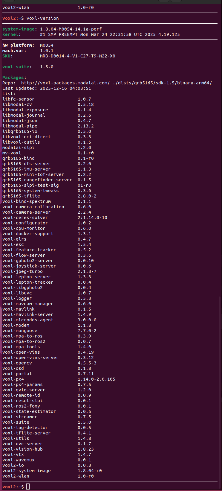

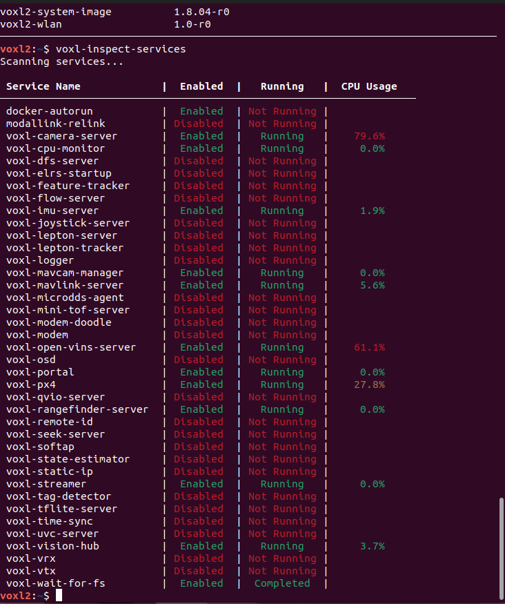

      Voxl_inspect_services:
      Voxl_version:

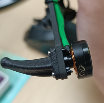

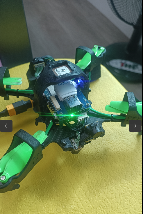

        Another typical issue with motors not spinning up is damage of motor windings due to mounting screws going into the windings (which could happen if the landing gear is removed, but the same screws are used to attach the motors). I am not saying this is the case here, but worth inspecting the motor windings on the under side, right where the motor mounting screws could make contact with the windings if the screws were too long.

        The rust on the inductor is only cosmetic. We are aware of this "issue", but it's really not an issue (rust on a iron case of an inductor - the case does not really affect the inductor itself).

          I inspected the problematic motor and found that its mounting screws did not appear to be screwed into the windings, as shown in the picture below.

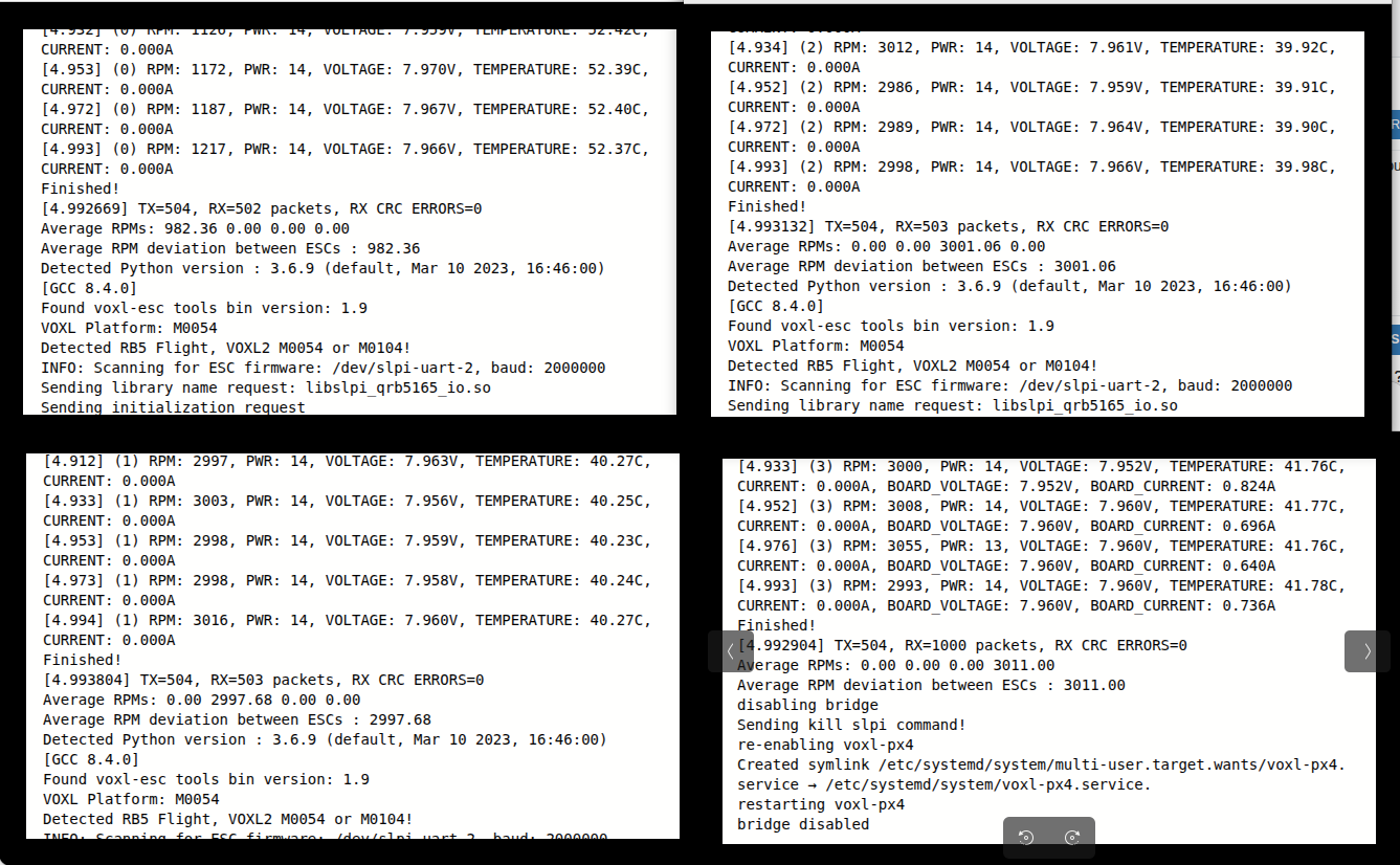

          Here are the results of voxl-esc_spin tests using two different power supplies:
          • The 12V AC/DC adapter appears to be working fine (adapter_voxl-esc_spin_test_video) (adapter_voxl-esc_spin_test_result.txt
          • However, the battery power test results show:
          1. Motor ID 0 is not working. (battery_voxl-esc_spin_test_video)
          2. The Average RPMs of Motor ID 0 detected by the voxl-esc tools is significantly lower than the other three motors. The image below is a partial screenshot of the data. Please click the link for the complete data.(battery_voxl-esc_spin_test_result.txt)
          Screenshot from 2025-12-22 17-32-26.png )
          Based on the above supplementary data, would you recommend that I send it for repair?
          Thank you very much!

            When i see results like this, i would say there is probably 90% chance that the motor is bad. Unfortunately, there is a chance that the ESC is bad as well, and there is no good way to check the ESC without a known good motor (however the ESC failure is unlikely).
            As I mentioned in the previous post, if you had a milli-ohm meter, you could test the motor winding resistance to confirm whether the motor is good or bad. A tool like that measures resistance with high precision (similar to a regular Ohm meter). However, if you don't have one, it may not be worth buying it..
            You will not be able to measure the winding resistance of these motors correctly with a regular Ohm meter. However, you will be able to detect a complete open circuit (which could be the case, maybe worth trying). If testing resistance using a regular Ohm meter, any two connections between the 3 motor phases will read 0 ohm (or close to that). If a wire is broken, then you can detect it.
            The Starling 2 motor (3000kV) has around 0.360 - 0.370 Ohm phase-to-phase winding resistance.
            In order to confirm that the ESC is working properly, you could temporarily connect one of the working motors to the ESC Channel 0 and do the same spin test (using voxl-esc tools), just to confirm that the ESC Channel 0 is working fine.
