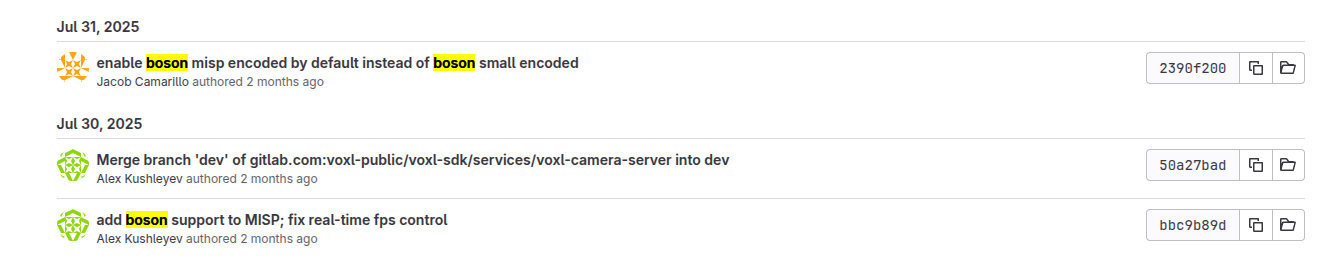

        In order to use MISP for boson, you need to have the camera server which includes the following commits:9d04960e-7034-487a-96ad-89d4308ba6f7-image.png -- see here : https://gitlab.com/voxl-public/voxl-sdk/services/voxl-camera-server/-/commits/master?ref_type=heads
