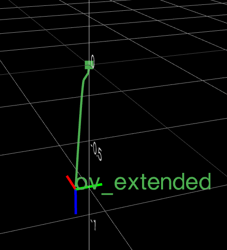

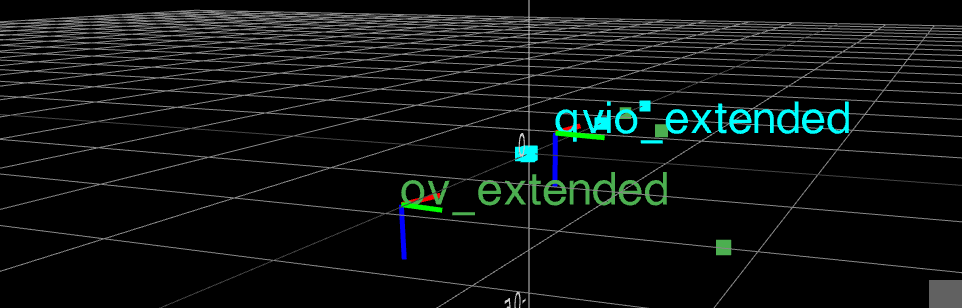

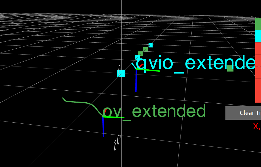

      Hello! very good morning! I am trying to develop a safe and efficient solution to control the drone in a simple way, the idea is to manage the drone through actions with the Mavlink server (I already have it, I can take off the drone from QGC) the problem is to get stability, the drone flies most of the time in an unstable way, i have configured the voxl-vision-hub with qvio, and i have also tried with ov, but in none of the two is stable, i take off the drone in position mode and what it does most of the times is not to keep its position, but to start flying uncontrolled, upwards or sideways.
      As you know this is totally inefficient and not applicable to the need I have, since basically the main thing is a safe and stable flight.
      I would like you to help me first to understand the difference between QVIO, VIO and OV (I have not seen anything in the documentation that explains well the difference between these three).
      And secondly to see if you can help me to be able to give the necessary configuration to be able to obtain a safe accuracy.
      I am going to leave you the configurations I have and the tests I have done.

      finally I share with you the tests I have done:
      1. take off the drone in the place where I connect the battery (failure)
      2. move the drone manually until I saw that the z-axis coincided more or less with the movement it made, position the drone at 0, and take off (here I got more stability)
      3. reset qvio and ov, after powering up the drone, the qvio was accurate but the ov was moving crazily on the plane when static (failure)
      here are some images of the inconsistencies between qvio and ov
      thank you very much in advance, and sorry if the thread is too big!
      tomT 1 Reply Last reply Reply Quote 0

                  @zauberflote1 @tom Hi Zauber and Tom! I have done everything you have recommended, I updated to version 1.5.0 of the SDK, I also did a complete calibration of both the cameras and the IMU and the PX4, I have checked the extrinsics file and it seems correct, I leave all the information I have right now. But I have not been able to get the drone to fly in a stable way, when taking off you get an extremely unstable flight, in which it can start to go up or down or move to the sides, this is extremely dangerous for a critical operation and in an indoor place, because generally there is not much margin for error, I need to solve this urgently! if you need something else let me know!

                  to finish I have also observed that at the time of take off the points are not fixed before take off, if not just when the drone is armed, I am sometimes results in a mismatch, for example in the image that I show below, I only armed the drone, there if the points appeared, but as I left the drone only armed (not lift it) I could see that the position of the drone began to go negative infinititamente, when not even the drone was moving.
