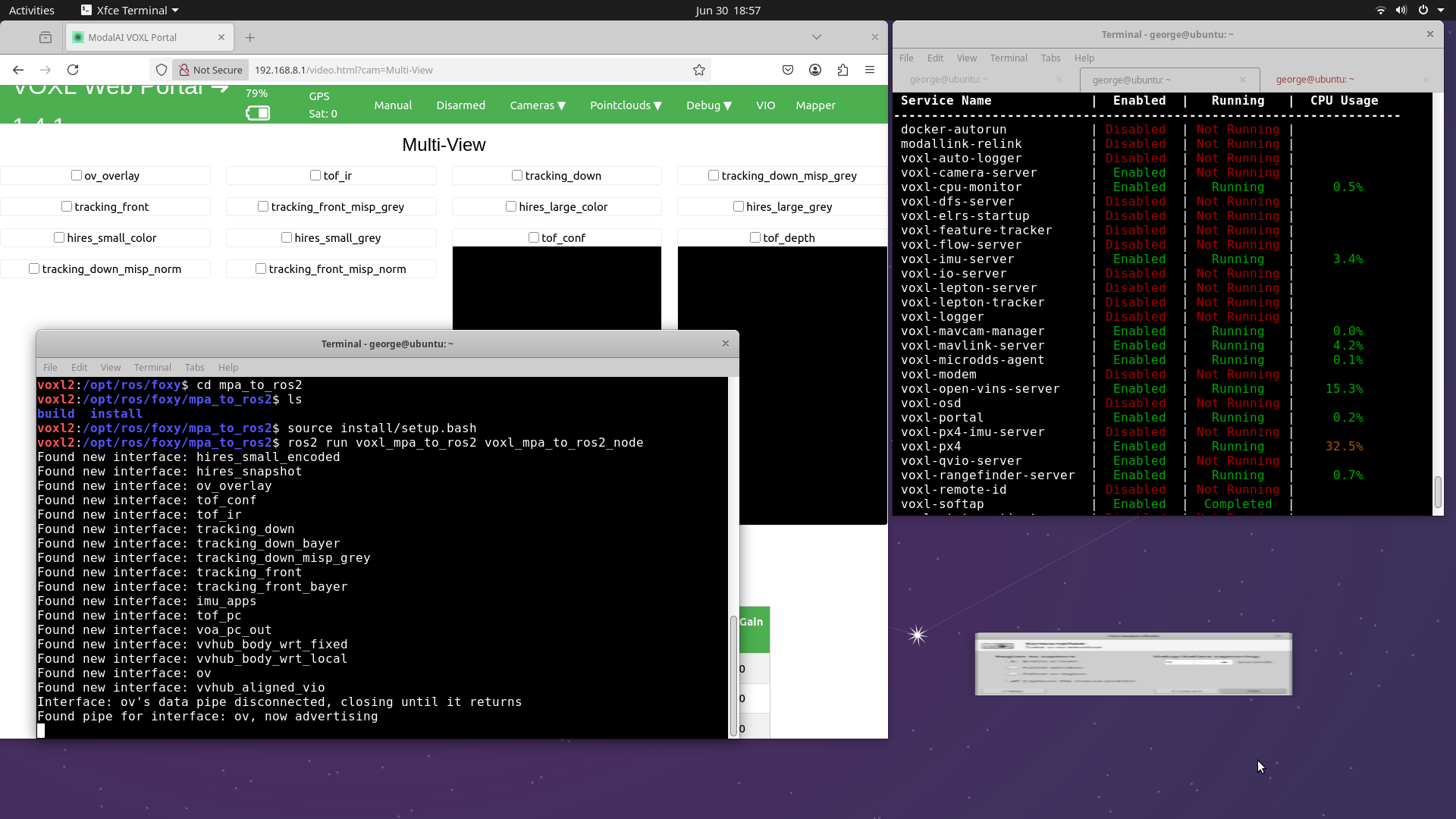

        Just noticed something with point #2.
        ros2 run voxl_mpa_to_ros2 voxl_mpa_to_ros2_node stops the voxl-camera-server, and we stop seeing some of the interfaces from which we want to access data (tof_pc, tof_depth, hires_small_encoded etc.)
        Could this be the reason why we're only able to echo only /imu_apps (which I assume is completely unrelated to the voxl-camera-server)?

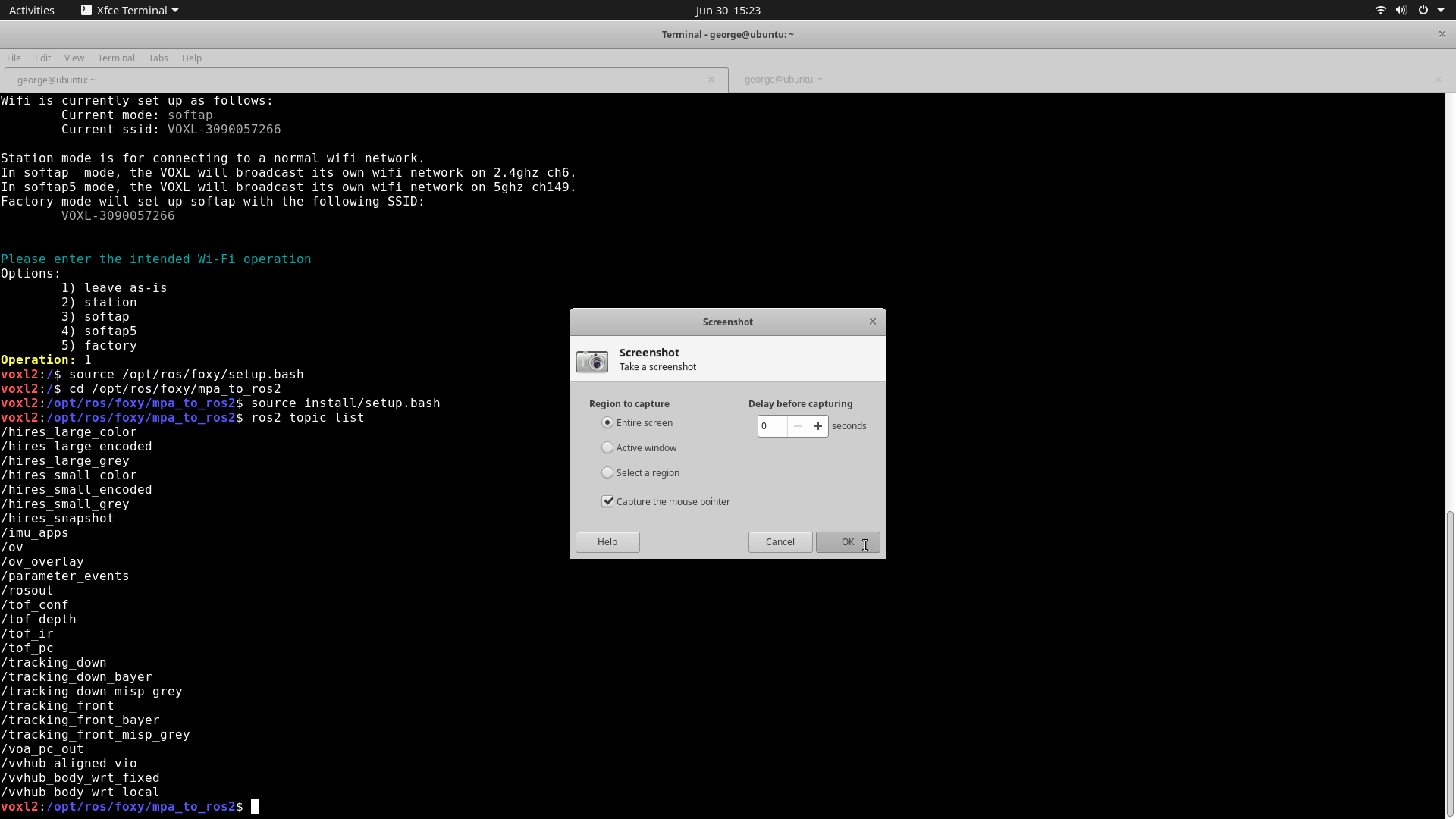

                @Aaron-Porter thanks for checking in. I'm able to see all the camera related ros2 topics now on the UAV and the laptop terminals.
                Cheers,
                George
