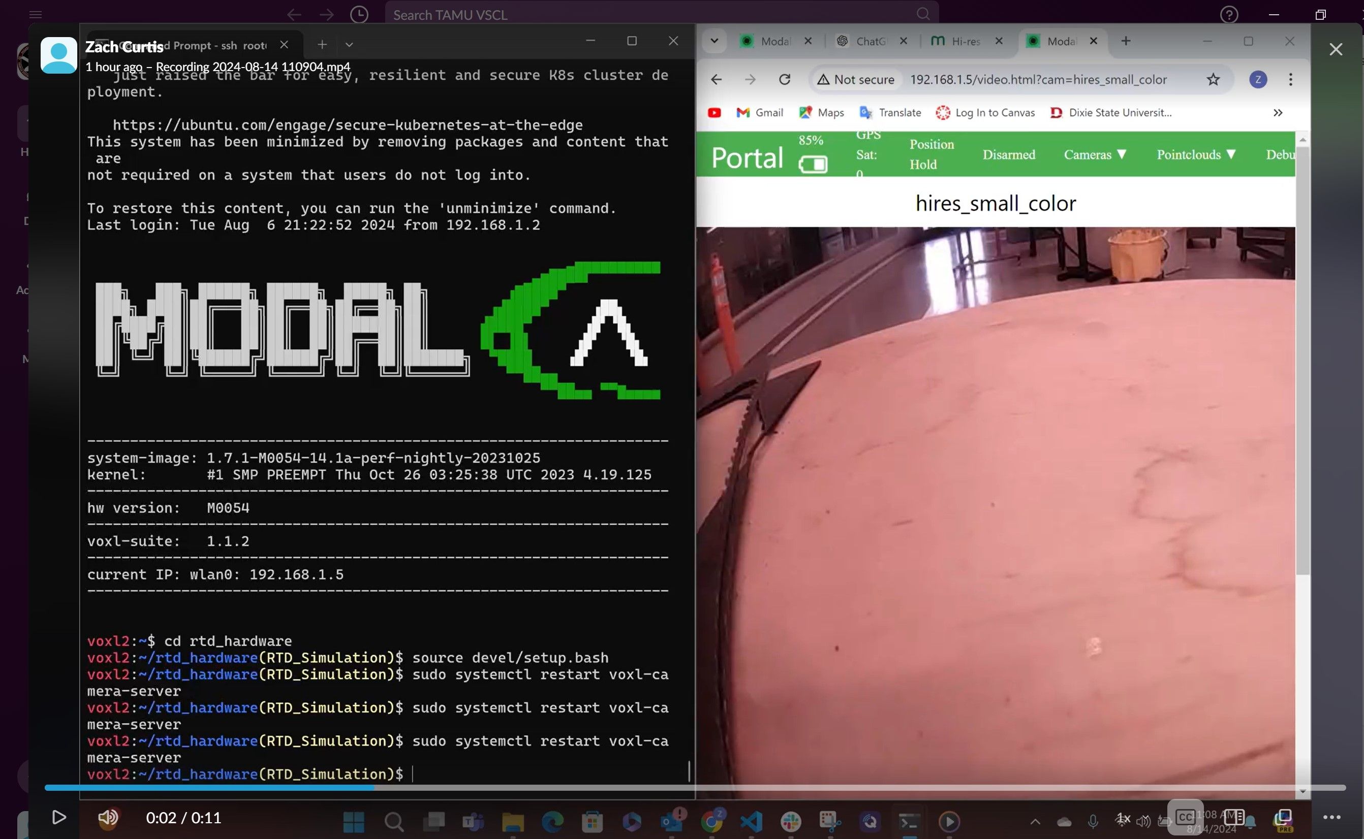

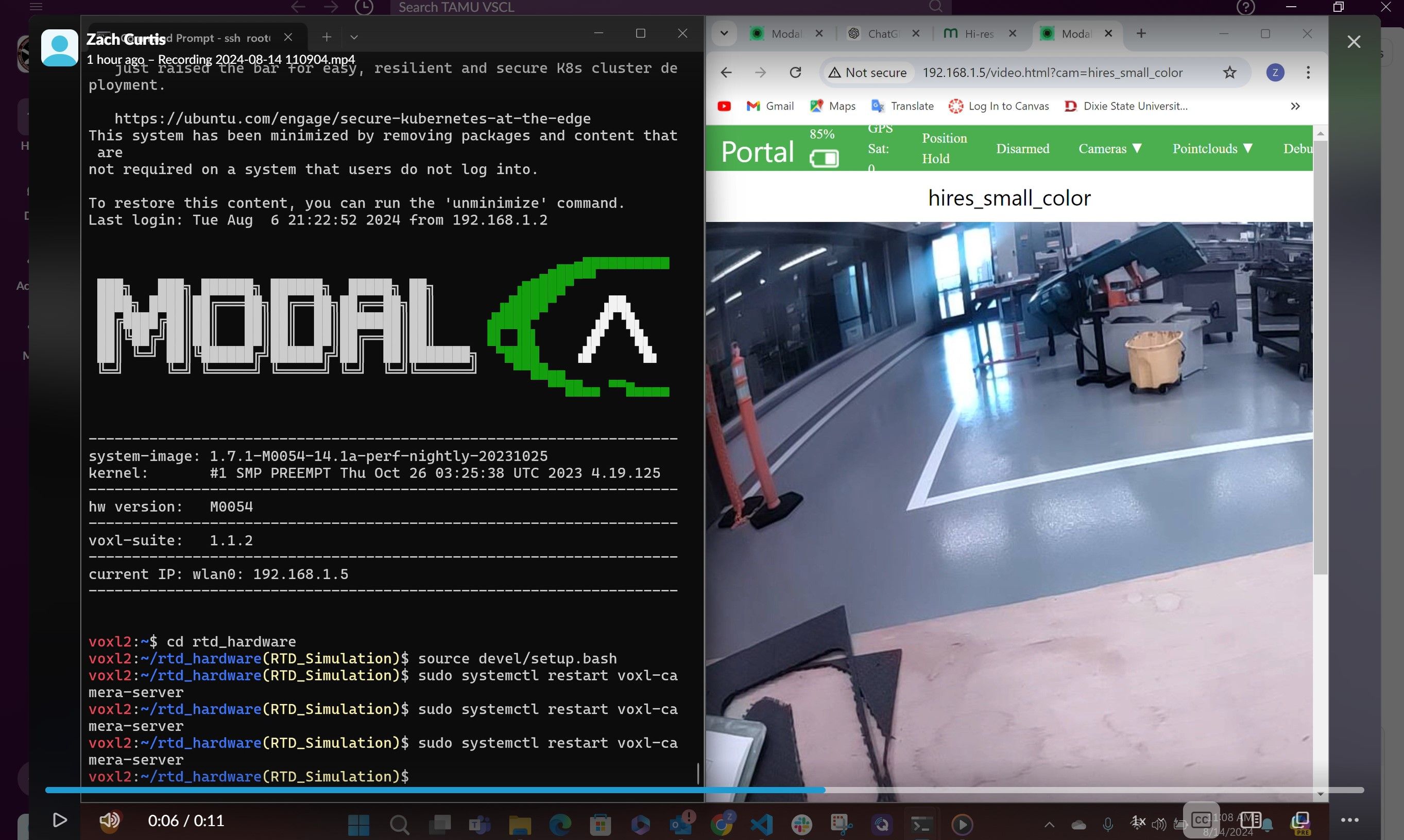

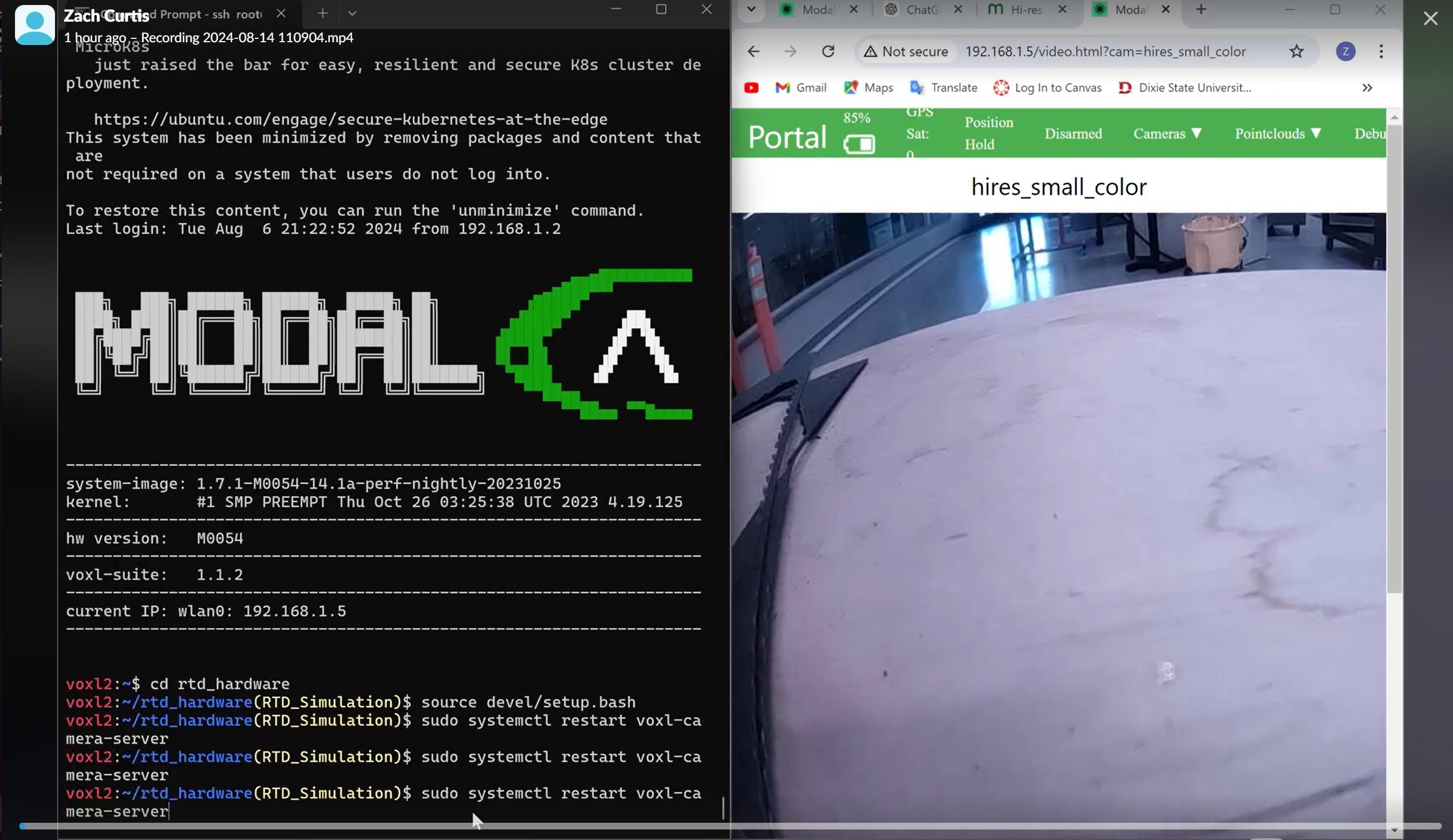

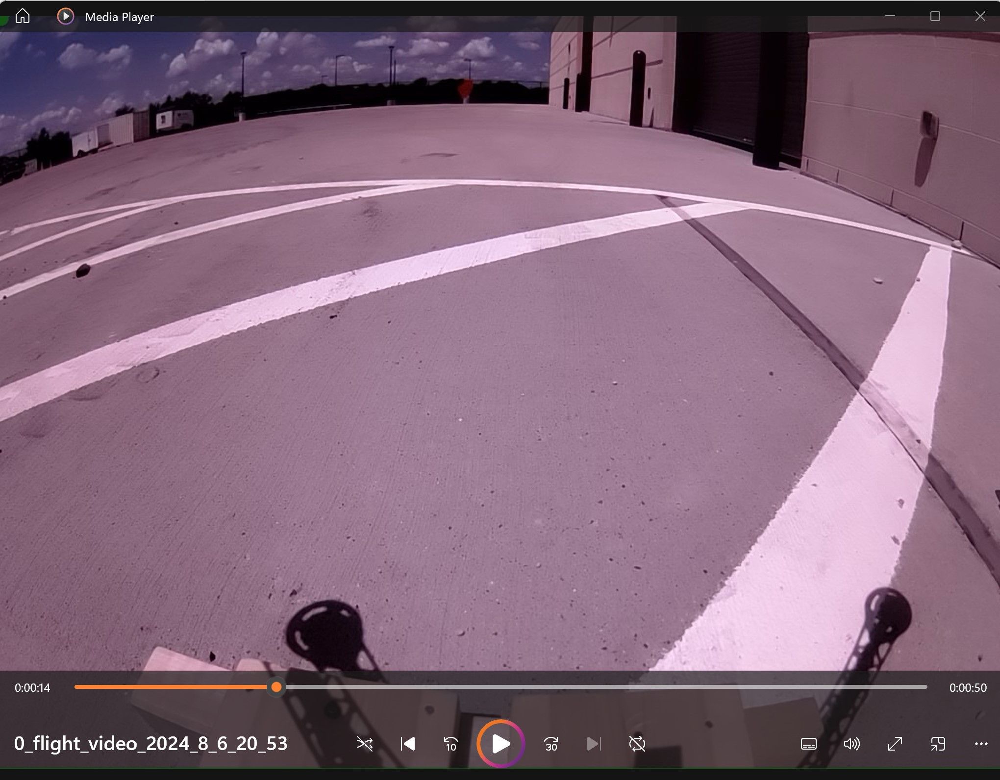

          zcurtis070 @Alex Kushleyev
          @Alex-Kushleyev this seems to have a positive effect but its not working perfectly and it doesn't work all the time. Inside on the workbench, I noticed that when I restart the voxl-camera-server it immediately shows up pink, but as soon as I lift the vehicle off the ground it seems to adjust settings and the color comes out closer to true color and what we are looking for (I have a video that show the behavior, but I am not sure how to post it here).
          However, I took the vehicle outside to perform a test and I was not able to get the pink hue to go away. I tried restarting the camera server and tilting it around hoping it would auto adjust the settings, but I didn't have any luck. Do you have any other suggestions?
          Before Restart
          After Restart
          After Lifting which causes auto-adjust
          Outside:
