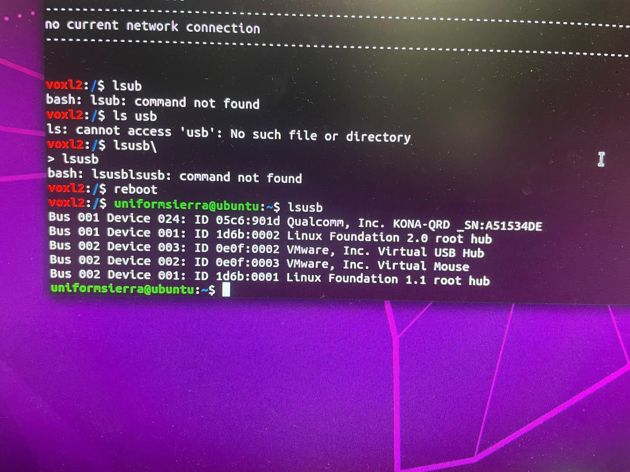

              Trevor Redpath @tom
              @tom
              So when I plugged it in everything lit up green and I could get into the shell. I still did the lsusb and got this back. Might have had my VM get bugged up at some point and just needed a restart to get it to work. I'll keep this post updated if I run into any more problems with the board.
              • tomT
                tom admin @Trevor Redpath
                @Trevor-Redpath Interesting yeah from that screenshot it looks like everything is functional. Like you said just update this post if things change
