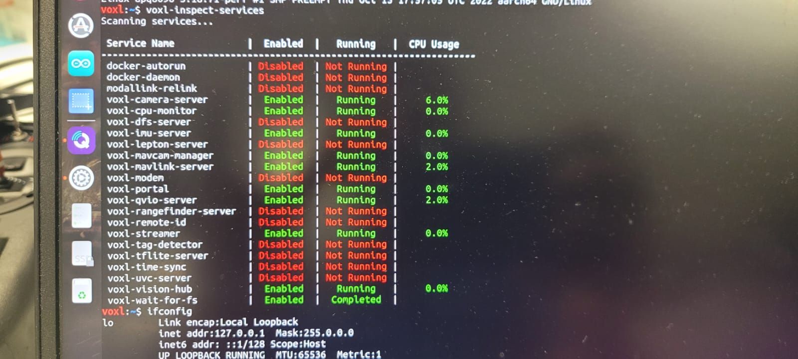

Hi team,

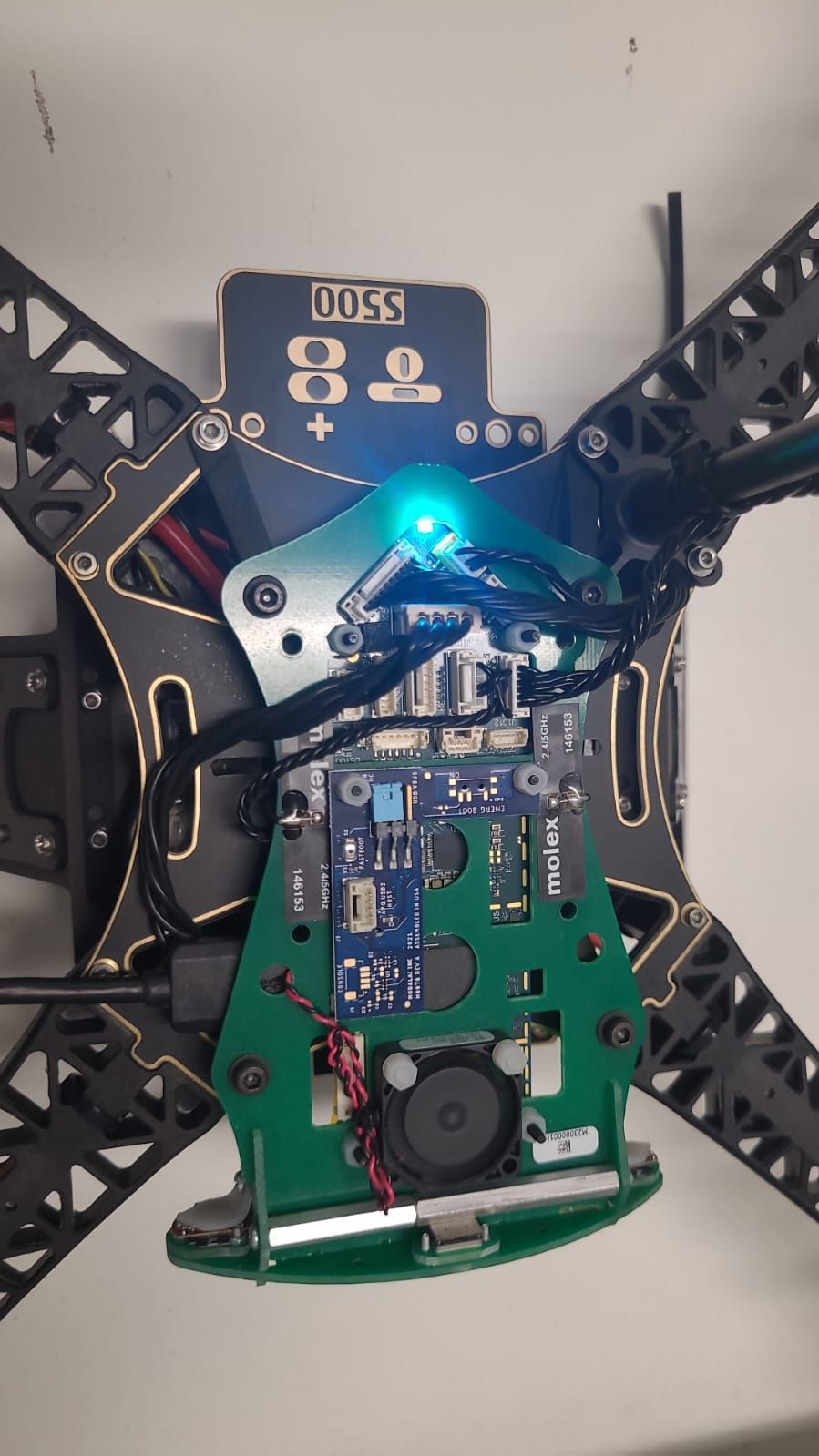

I'm working with a VOXL-based drone (VOXL m500), and PX4 seems to be completely missing from the system. Here's what I’ve observed:
Issue Summary
Running voxl-inspect-services shows no entry for voxl-px4.PX4 command is not found (px4: command not found).
No mention of PX4 binaries or service on the system.
