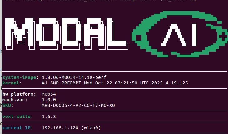

        • D
          DronAlan @DronAlan
          • tomT
            tom admin @DronAlan
            @DronAlan https://www.modalai.com/pages/rma
