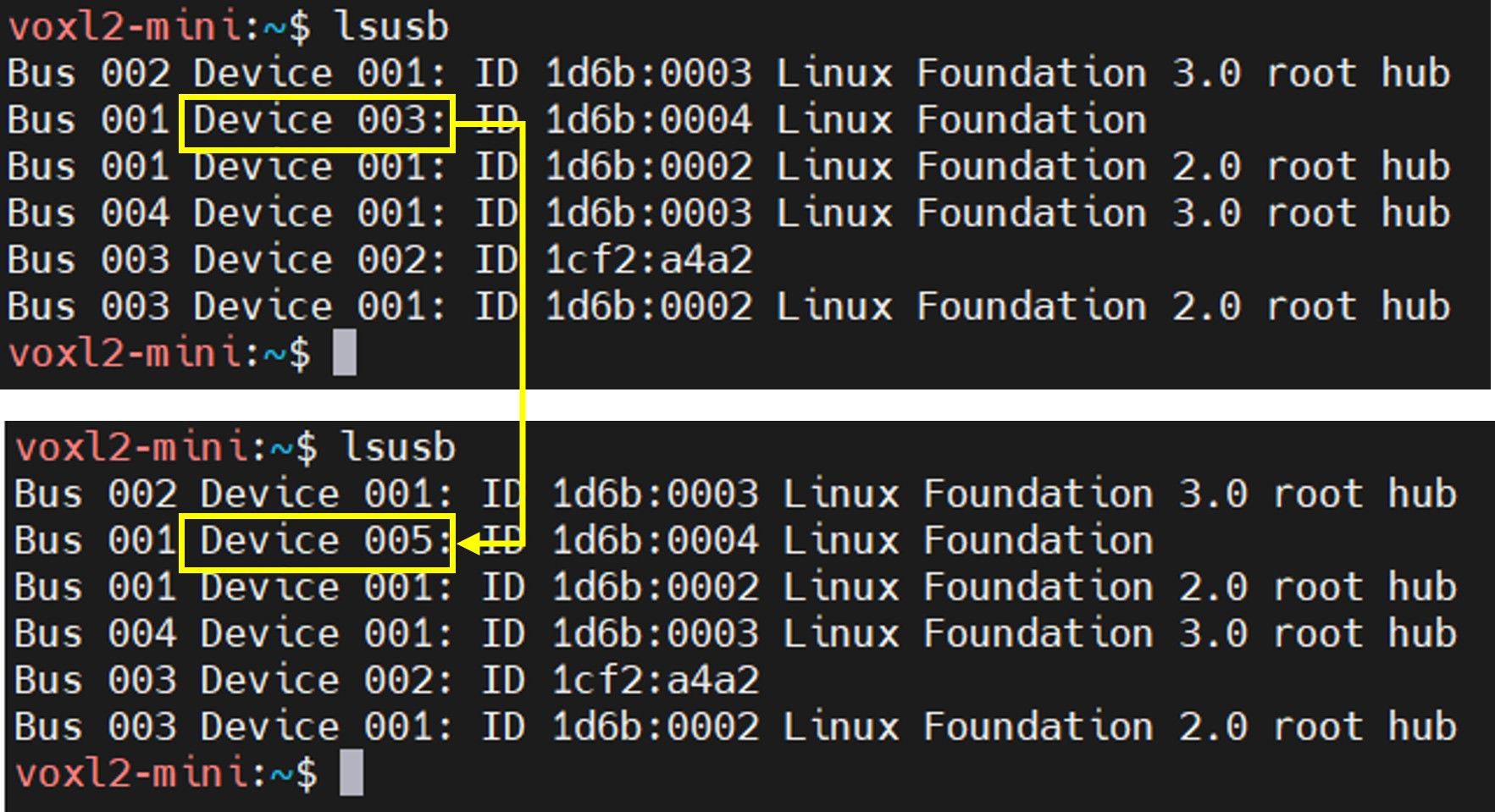

      We are using the voxl-mini as shown below.
      • hw platform: M0104
      • voxl-suite: 1.4.5
      • SKU: TF-M0104-6-V1-C6
      • video codec(voxl-streamer): h.264
      • Web camera: uvc(YUY2) format
      [Inquiry]
      1. We are using a web camera.
      2. The Device ID changes when the camera is turned back on (see figure below).
        Therefore, we execute the command "systemctl restart voxl-uvc-server" every time.
      3. Please tell me how to fix the Device ID.???
      Thank you.
      Kim.

        Hi Support team,
        I would like to know how to resolve the issue regarding the DEVICE ID change.
        Could you please provide a solution for the above?
        e.g., Will creating a udev rule file resolve the issue?
        Thank you.

            Jskim
            The Device ID continues to increase.
            We are using a webcam with a built-in SD card.
            We switch between SD card mode and Webcam mode by pressing a button.
            When power is supplied to the camera, SD card mode is set by default, and pressing the button switches it to Webcam mode.
            The DEVICE ID number increases every time the camera is connected.
            Thank you.
            Kim
