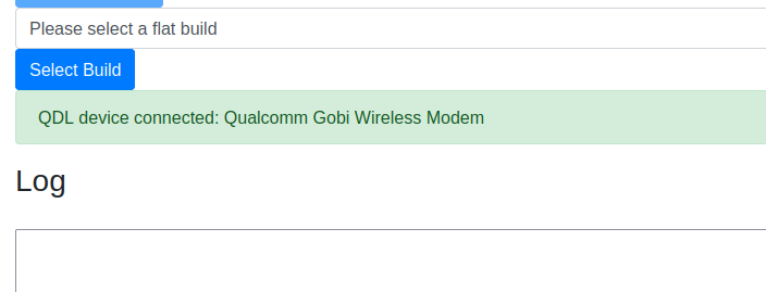

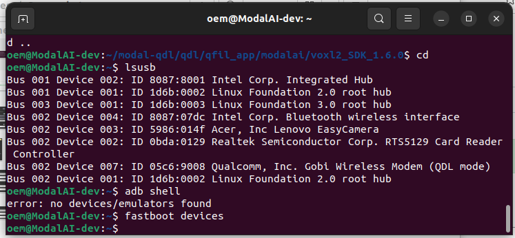

      I have a fully bricked VOXL2 on a Starling 2 Max. I have gone through the forum and documents processes without success and have concluded that there is way more wrong than a typical unbricking can fix. Give you a little history here... This thing has bricked a couple of times and I was able to easily make a full recovery. I updated the SDK to 1.5.0 after the first bricking and everything seemed to be OK. I was going to test a new GPS module (issue submitted under a different forum topic) and had the WiFi set to AP mode so I could connect wirelessly. I powered everything up on the bench, connected via ADB and ran voxl-inspect-gps to see if the new module was detected, and it was. Thinking everything was GTG, I powered down and took the drone outside to verify that it could see satellites. Powered it up and waited for the SSID to become visible and it never did, even after a couple of power cycles. So, back to the bench with it.
      I attempted to do yet another unbricking only to discover that I couldn't communicate with it via USB. adb shell returns no device found and putting it into fastboot (presumably) and fastboot doesn't detect a device either. The only way I see the device is with lsusb or the web interface shown below.
      screenshot-from-2025-11-06-15-11-45.png screenshot-from-2025-11-11-11-13-52.png
      I find it interesting that it can be detected but not respond to external commands - the lights are on but nobody is home.
