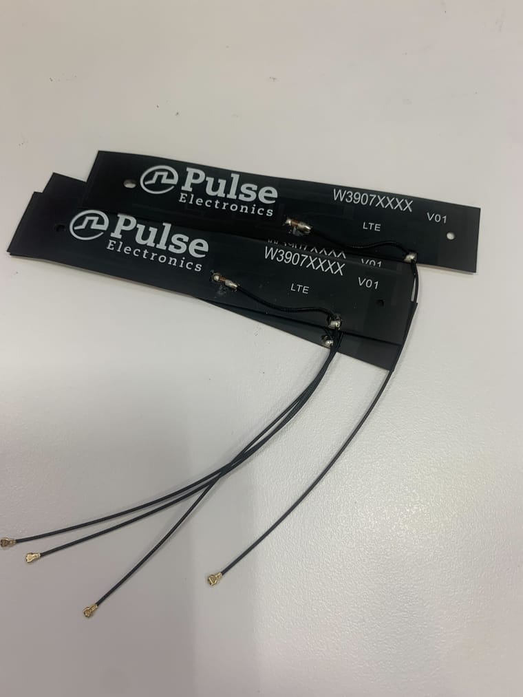

        One more question: Should we use 5G antenna, not LTE? As I know when we buy the 5g modem the default antenna is the one with LTE.
