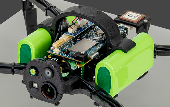

      1. In the C29 configuration, where is the ToF sensor mounted? Is it similar to the regular Starling 2? I am assuming so but I did not see an image showing the location or the product page or documentation confirming it.

        1. here is what the TOF sensor mounting looks like, right next to front-facing IMX412 and AR0144 cameras.
        2. Starling 2 and Starling 2 Max are very similar in terms of what software they are running. If you are able to run the mapping / navigation on a Starling 2, then you should be able to follow the same steps to get it to work on Starling 2 Max (sorry for lack of details, but it seems you just want to confirm that the same functionality is supported, and the answer is yes). Please note that getting the navigation and mapping to work well in your application will require testing and tuning.
