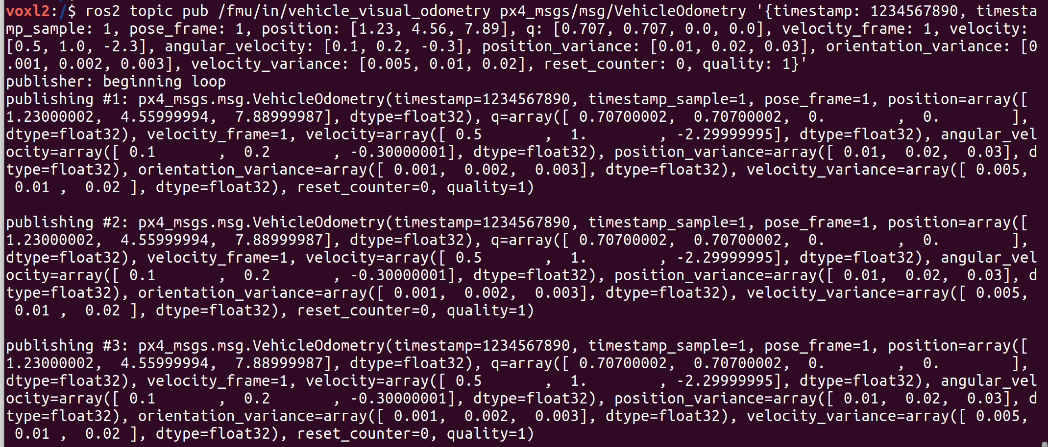

      The flight cage I am using has an Optitrack motion capture camera system installed that communicates my Starling 2 drone's position data on the LAN using NatNet protocol. I have a ROS 2 package on my computer that can receive this data. I plan to transmit this data to the drone after it has been converted to the appropriate format. By referencing this guide, I see that mocap data should be published to the vehicle_visual_odometry topic. When PX4 is running on the drone, I can access the ROS 2 topic /fmu/in/vehicle_visual_odometry. However,when I publish test data to this topic it does not have any obvious effect. By using the ros2 topic echo command I can see that the data is indeed getting published. However, echoing the /fmu/out commands return nothing, including the commands that are supposed to return the drone's position.
      Publishing to /fmu/in/vehicle_visual_odometry
      Listening to /fmu/in/vehicle_visual_odometry while publishing topic
      Attempting to listen to /fmu/out topics
      When I disable PX4 with systemctl disable voxl-px4 I am able to view the data from these /fmu/out topics. But still, publishing to vehicle_visual_odometry does not change the /fmu/out readings that display vehicle position.

          @Zachary-Lowell-0 I said yesterday that echoing the /fmu/out topics only worked if voxl-px4 was disabled on startup and run in a terminal with voxl-px4. This no longer appears to be the case, although I don't know what changed from yesterday to cause this. Now ros2 topic echo can print those topics when px4 is launched at startup. However, the topics still don't print the data I would expect if the drone were correctly reading the data I publish to /fmu/in/visual_odometry, unchanged from yesterday.
          The qvio server was on. I disabled it, but that didn't fix the issue of the drone not using the data from /fmu/in/vehicle_visual_odometry. I believe that shutting down this server should disable VIO, correct? This is the output after disabling qvio server and having px4 enabled to launch at startup.
          Here is the output of /fmu/out/vehicle odometry when I am not publishing to /fmu/in/vehicle_visual_odometry
          And here is the output when I am publishing to it using the command topic pub /fmu/in/vehicle_visual_odometry px4_msgs/msg/VehicleOdometry '{timestamp: 1234567890, timestamp_sample: 1, pose_frame: 1, position: [1.23, 4.56, 7.89], q: [0.707, 0.707, 0.0, 0.0], velocity_frame: 1, velocity: [0.5, 1.0, -2.3], angular_velocity: [0.1, 0.2, -0.3], position_variance: [0.01, 0.02, 0.03], orientation_variance: [0.001, 0.002, 0.003], velocity_variance: [0.005, 0.01, 0.02], reset_counter: 0, quality: 1}' which is supposed to provide it with test mocap data.
