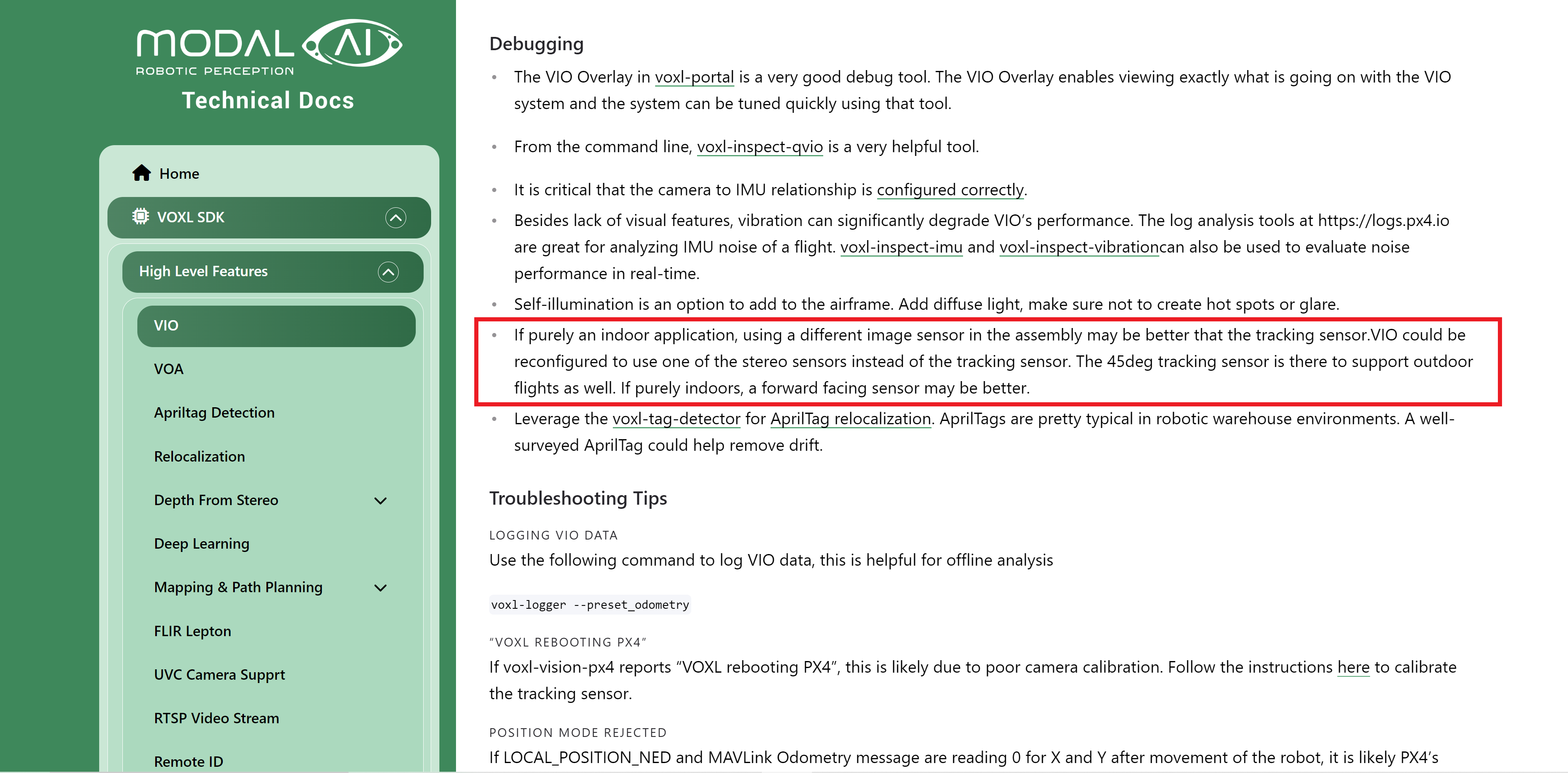

      Hello, I am trying to reconfigure one of the Seeker's stereo image sensors to be used for VIO instead of the tracking image sensor. I found the documentation on ModalAi's website, but it does not explain how to do this. Could someone please help me out with this?

        I was thinking that reconfiguring this would be located in the camera configuration, but there isn’t a “ TOF + Stereo “ option here.
