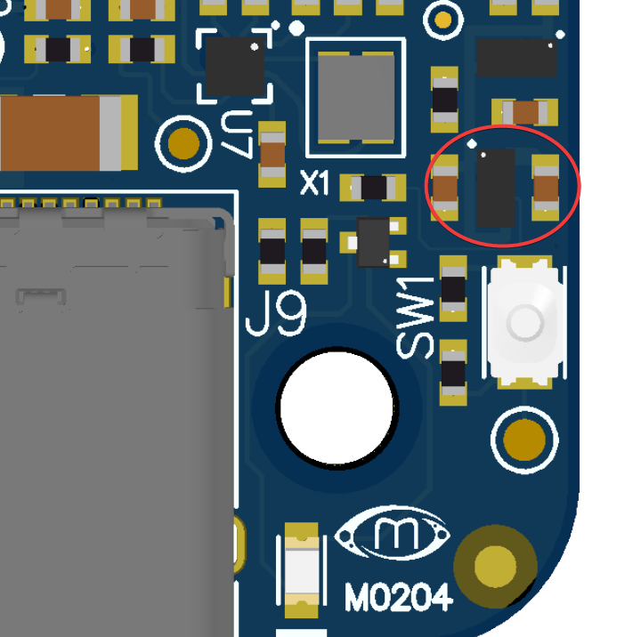

        Hi Cbay,
        There is a small clock buffer on the edge of the PCB. An RMA can only replace the whole board, not replace a single device. The part to check would be here: image (1).png
