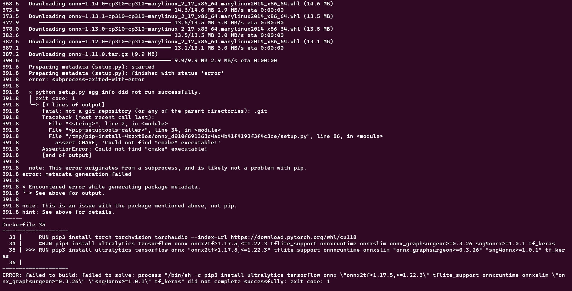

      We having issues building the docker image. Attached is a picture of the errors we are encountering.
      We have tried install the dependencies individually with little luck. Any assistance would be greatly appreciated
      Thank you

        Hi Jeremy,
        i just replicated this issue and was able to build the container by making the following changes to the docker file. Try adding these on your end and see if this resolves the issue.

        RUN pip3 install torch torchvision torchaudio --index-url https://download.pytorch.org/whl/cu118
        RUN pip3 install cmake
        RUN pip3 install protobuf==3.20.3
        RUN pip3 install onnx
        #RUN pip3 install ultralytics tensorflow onnx onnx2tf>1.17.5,<=1.22.3 tflite_support onnxruntime onnxslim onnx_graphsurgeon>=0.3.26 sng4onnx>=1.0.1 tf_keras
        RUN pip3 install ultralytics tensorflow "onnx2tf>1.17.5,<=1.22.3" tflite_support onnxruntime onnxslim "onnx_graphsurgeon>=0.3.26" "sng4onnx>=1.0.1" tf_keras
        J 1 Reply Last reply Reply Quote 0
        • J
          jeremyrbrown5 @Robbie McCue
          @Robbie-McCue worked, thanks so much!
