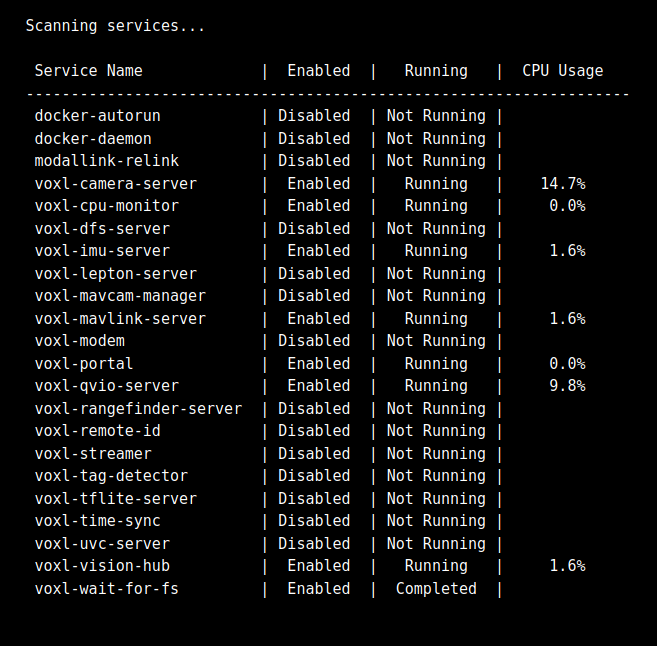

      Now what I have tried. I tried different veersions of QGC 4.4.0 was the oldest i tried so far. And all show that they are disconnected without any indication of connection. I use separate device connected wither to soft IP or the wifi router to monitor the ip adresses, plannign to try track packets being send but at moment all devices do not change ips. Below i am attching the services running on the drone.
      ![alt text](Screenshot from 2025-04-24 14-06-45.png image url)
      I feel that I am lost as the first drone which was mentioned in the post above, seems to be bricked with me not seeing it in adb either, and not being able to flash newer version of VOXL.
      If there are any ideas or potential steps or logs I can provide I will, but at this moment I am ta loss.
