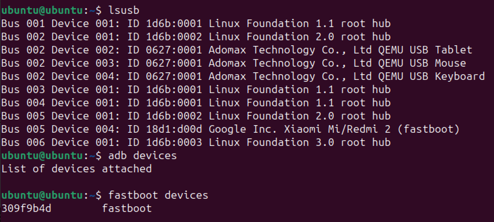

    Hello, I just started working with voxl2.
    I just have an issue with the configuration.
    Somehow I cannot see any adb values, but they show in fastboot. Is there any way to fix this?
    Any help will be appreciated. Thank you.

      @Paola-Lim The board can either be in "adb mode" or "fastboot mode". To go from adb to fastboot you can use adb reboot bootloader and to go from fastboot to adb you can use fastboot reboot
