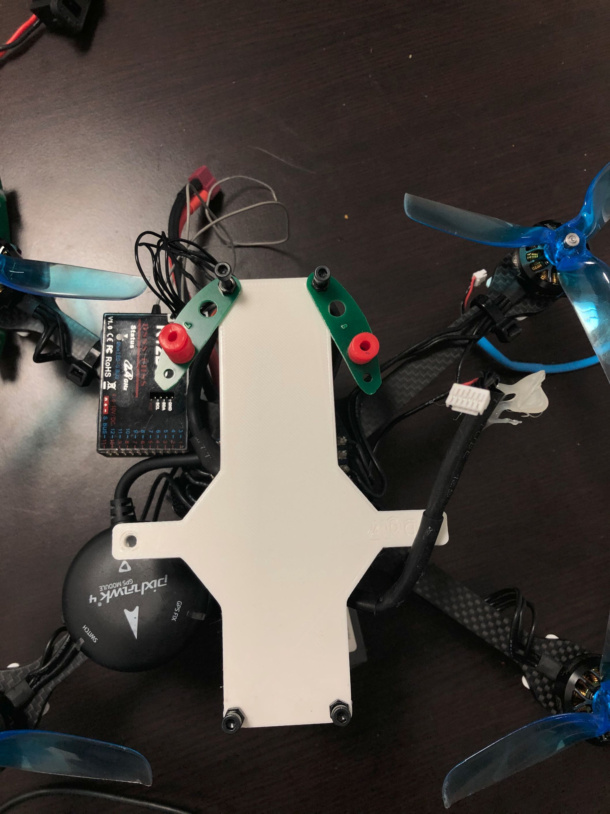

      What are you connecting to the Flight Deck? Are you able to share a picture or block diagram of what's being connected?

        Hi @modaltb I have connected the power adapter that came up with the flight deck. We received this board just a few weeks ago. I have attached an image for your reference.

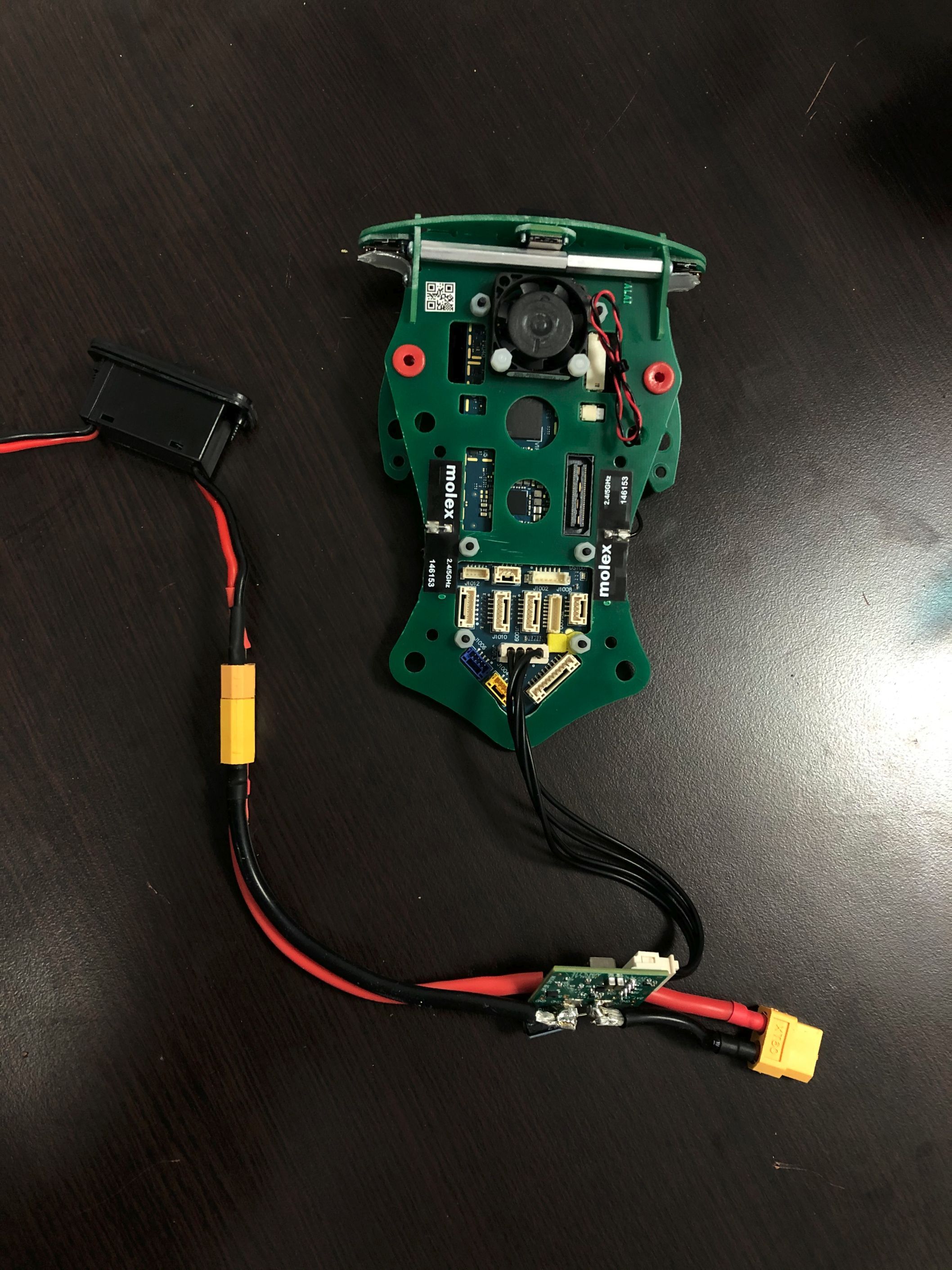

          here's the working image. You can see that the VOXL has turned on here.image_67132161.jpg
          But no luck with the PX4.

            The Green LED you see there should never be active, it's a 'spare' LED for the FlightCore (PX4) side

            So if this LED is on, and the firmware hasn't been modified, then it's highly possible that the FlightCore side of the system (with the STM32 microcontroller running PX4)has been damaged 😕

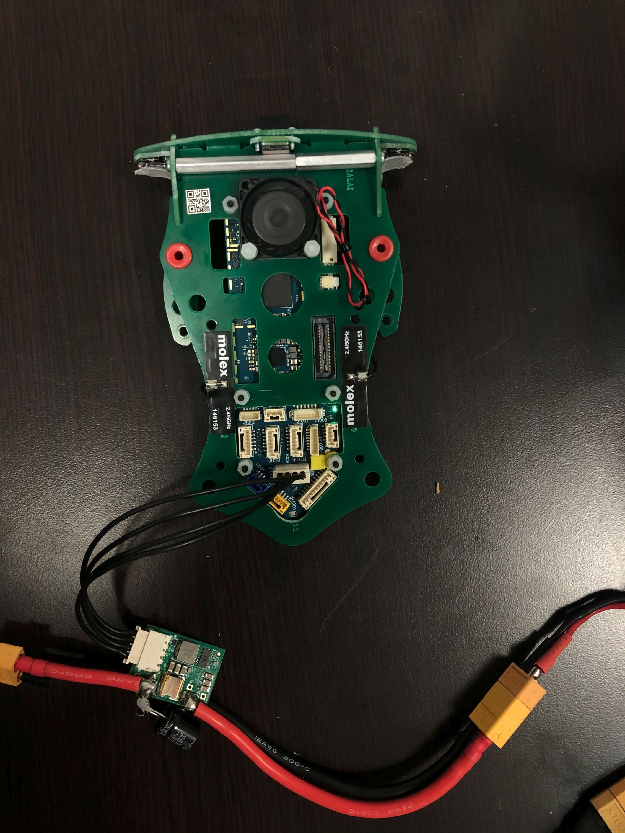

                One quick question is with ESD safety. In the photo above, the back 'legs' are removed and the FlightCore PCB would be physically touching the table. This is 'probably' OK but without a properly grounded ESD mat, there's always a chance of inducing failures from ESD (rare, but possible, especially in low humidity).

                  @modaltb it was mounted properly. I just took it down to click a proper picture for you. Here's the image.

                    OK got it.
                    I'm assuming it's not connecting even with the USB connection straight to QGC, if that's the case we'd need to investigate further as to what is going on and that means sending into the factory for an analysis unfortunately.

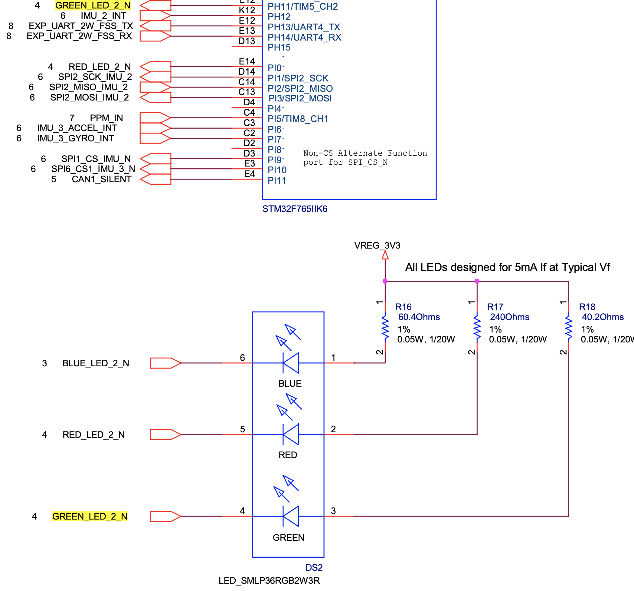

                    Likely the STM32 has been damaged in some way, as DS2 (the second LED) only turns on if programmed to do so and it's no, meaning that the pin is in 'wrong state' but more likely the pin has been fused to ground... There's nothing else in the path in the schematic that would allow the LED to be enabled.
